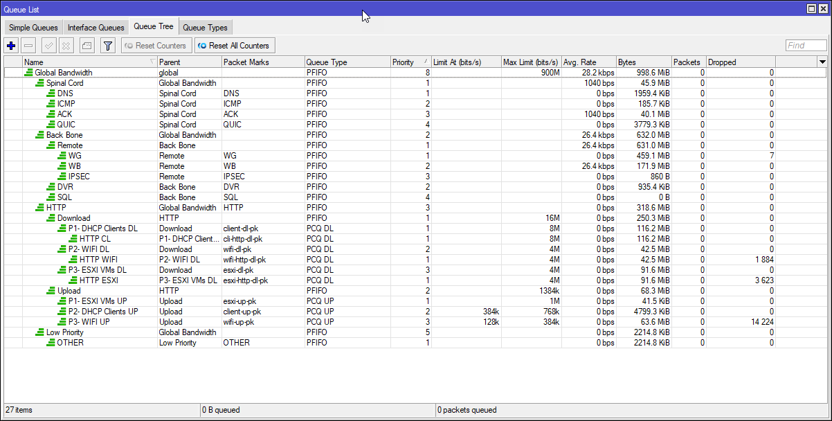

Did you ever get this working? I was looking for something similar, but thus far none of it makes much sense. Also, priority 1 is higher than 8 or is 8 higher than 1, funny how none of the wiki-pages actually state that simple fact. Very confusing!
1 has a higher priority than 8, I didn’t read all the comments, but I don’t think that it is achievable VIA simple queue CUZ the priority of the first rule is always higher than others.
So if you want to prioritize your BW the same for all the rules you should use tree queue.
