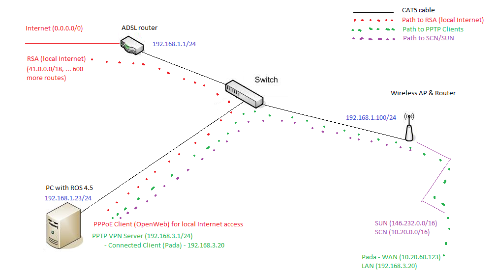

Here’s a diagram of my network layout.

The information I have is that the proxy system will only use the main routing table, so you can’t split proxy traffic over a number of connections. You can split everything else though, and just let your port 80 stuff go out your primary connection.
Thank you gmsmstr. I’ll try to setup the transparent proxy to cache the more expensive Internet connection’s contents then, by specifying the route-marking for the proxy redirect NAT entry.
Another idea that I had was to host an additional RouterOS instance that is hosting the web proxy & PPTP server, and then it simply routes all the outgoing traffic to the second RouterOS instance that does the splitting.
The downside would be that you would require an additional RouterOS license?
