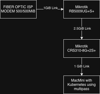

Here is picture of my current network infrastructure important for the issue.
On RB5009 I have static public IP and some dst-nat to send all traffic for port 443 to MacMini which is in separate 10.50.0.0/16 and has IP 10.50.0.2. On the same MacMini I have kubernetes cluster using multipass where master has IP 10.50.50.0 for kubectl access, and 10.10.0.10 via MetalLB for http/s access.

Up until 3 days ago on the palce of CRS310 I had dumb TP link switch and MacMini was connected via WiFi (vlan assigned via WiFi Access List), and all of this worked like a charm but I had speed issues.
How everything is configured:
On RB5009 vlan interfaces are setup with proper dhcp servers and bridge vlan filtering enabled. It was like this before CRS310.
On CRS310 I also enabled bridge filtering, did not create vlan interfaces, just added bridge trunk/access ports as per connected devices and also populated the bridge vlan table same as on the RB5009.

Rest asssured, you didn't. :astonished_face:
Post the configurations of BOTH the RB5009 and of the CRS310, so that some more experienced members can understand if there are issues in those, instructions here:
Besides the above, it is not clear (at least to me) is FROM WHAT/WHERE you are trying to open the site(s).
