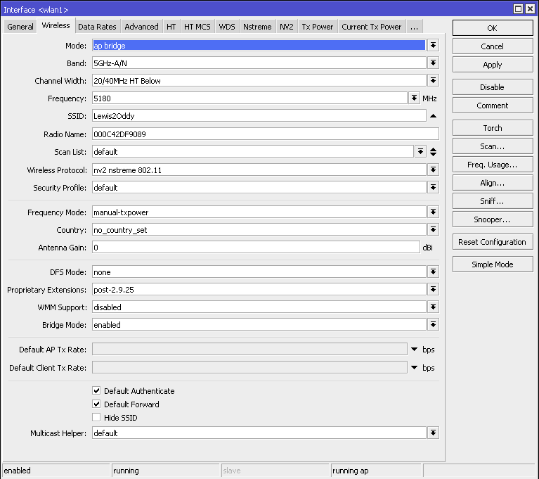

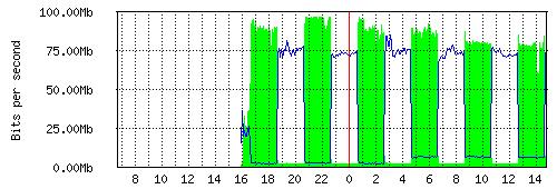

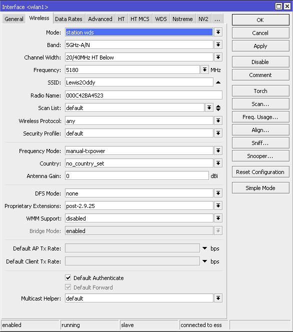

is there any online tutorial in order to try ?
in attached images you can see my setup, i now test them in the same room, using RIC/522c enclosures/antenas with RB912UAG-5HPnD..
running iperf using the following parameters iperf.exe -fM -t7200 -P 4 -w 512k -c 10.122.2.117,
changing direction every 2h..

#Ibersystems, do you think this throughput is ok for a link in the same room ?
i generally prefer routerboards, but i tried 2 osbridges last week, and they seem also heavy duty and robust..
and the performance is a flat line at 100mbps..
try to low the txpower to make tests in a room.
Fix it to 5 or 12 and try again.
