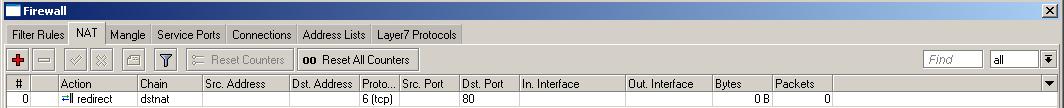

I need a transparent proxy to my lan 192.168.1.x/24 but the next rule not working in mkt V3.14
ip firewall nat> add chain=dstnat protocol=tcp dst-port=80 action=redirect to-ports=8000
In other mikrotik v2.9.51 the last rule work fine, has changed the rule to v3.X?

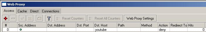

The rule not count packets and the proxy not block the website and not save any cache. So I tried with other version of MKT V3.X and the result is the same. Other thing that I did was modify the value of the Connection Limit 100/32 to 0/32 and this not helped me :frowning:

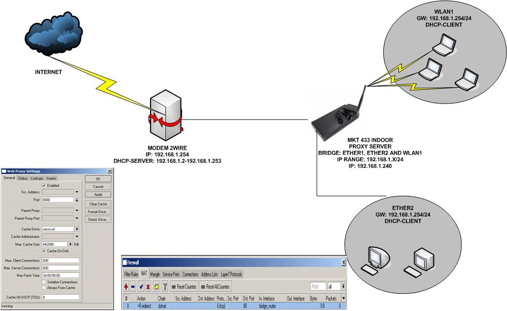

hmmm… you don’t use bridge, do you?..
Yes I’m using a bridge (Ether1, Ether2 and WLan1). In the Ether1 is connected the cable to Modem “2wire”, the Ether2 and WLAN1 are my client network.
This is an example about I want to do. When I configured a Hotspot into MKT all work fine but if I want do without Hotspot like the picture then the proxy not work. :frowning:
Thanks for all.
Dont forget in V3 you have to go to the bridge settings and tell it to use the firewall, perhaps that is why nothing appears to be passing through the firewall?

Thanks for the reply, finally the proxy are workign :smiley: I just enabled in Bridge setting “USE IP Firewall”
