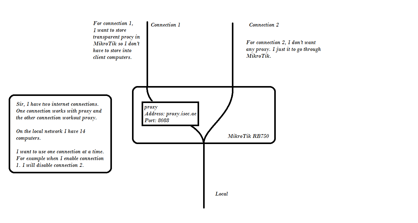

I have internet cafe where I have two internet connections. One connection works with proxy, so I have to store proxy in client computers to get the internet running.
The second internet connection does not require proxy. So, when I need to connect the second connection then I have to disable proxy from all my client computers.
Can you please look at the attached picture. You may understand more from it.
If possible, please provide me with a script.

I don’t want to balance these connections.
I will only use one connection at a time.
Then set up a NAT rule that you will enable when you unplug a port, or enable the NAT rule with a script on a link failure. Just modify the NAT rule to fit into your situation.
Okay, Now I have configured a simple router. Now how do I redirect clients through proxy? Give me script.
I want to put the following proxy in between ‘WAN 1’ and ‘LAN’.
proxy address = proxy.isec.ae
port = 8088

I have configure proxy using the following script, but now I want this proxy in between WAN 1 and LAN.
Please guide me on how to bypass WAN2 to LAN without using proxy?
