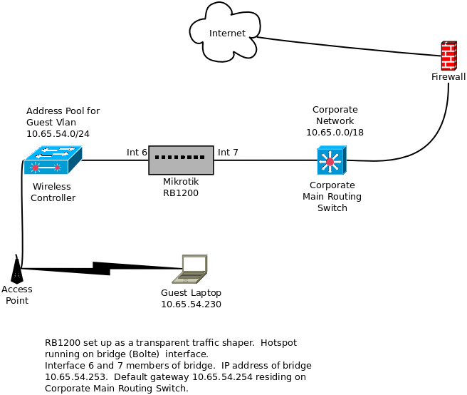

I am trying to set up a transparent traffic shaper using a hotspot on a bridge interface. This setup is in the middle of our corporate network as shown below:
My problem is that when I activate the Hotspot I don’t get traffic passing through it. If I open a browser on a a client machine it eventually times out with a “host not found” message.

It almost seems like there is arp poisoning but I don’t have any IP Pools turned on. I feel like I am missing something simple and obvious but I have deleted the whole configuration
and recreated it a number of times. Anybody have any ideas?
