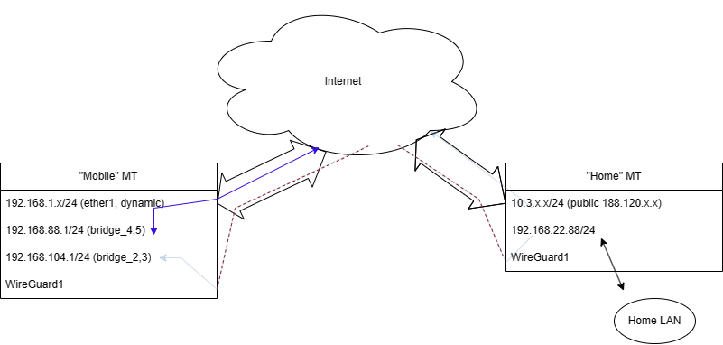

I tried to draw the diagram:
What is already working, is WireGuard1 connection, both sides communicate without problem. There are already the bridges on the “Mobile” MT.
All devices connected to the ports assigned to the bridge_2,3 (ports 2 and 3) should go to the internet through the “Home” MT via the WireGuard1 and also communicate with all the devices in Home LAN (they all have addresses like 192.168.22.x/24).
All devices connected to the ports assigned to the bridge_4,5 (ports 4 and 5) should go to the internet directly connected to the port 1 at “Mobile” MT. They do not need to (not necessarily “must not”) communicate with the devices at bridge_2,3 and all devices at Home LAN.
I hope I made it clearer a bit now :slight_smile:.
