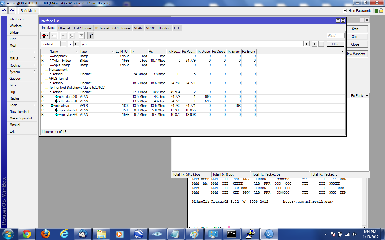

I’m new to the Mikrotik world so I would greatly appreciate any help you might be able to lend me. I have to say that I’ve had an eye opener having dug into what RouterOS can do, wow! I am trying to set up (LAB) a configuration to transport several vlans over a VPLS Tunnel. I can/have set up the VPLS Tunnel and verified Layer 2 connectivity between both sides. What I can’t seem to get working is transporting one or more vlans. Interesting, and likely I am not understanding what I am seeing, I do show traffic on the vlans on both the vpls and ethernet interfaces. However, I do not have layer 2 connectivity. I understand MTU size plays a crucial role. I have played around with MTU settings for MPLS, VPLS, etc (my config will probably look hacked up now). I’m obviously missing something. It could even be how I have my VLANs set up. Once I get it working in my lab I’ll end up deploying across my backbone/Cisco. I do understand that, again, MTU is critical and that ALL interfaces transporting traffic must have a minimum MTU; while I’ve found there is some difference of opinion as to what that should be. I run Jumbo Frames to support WiMAX over my Dragonwave backhaul. I’ll post the config of both sides and a few screen shots to visualize.

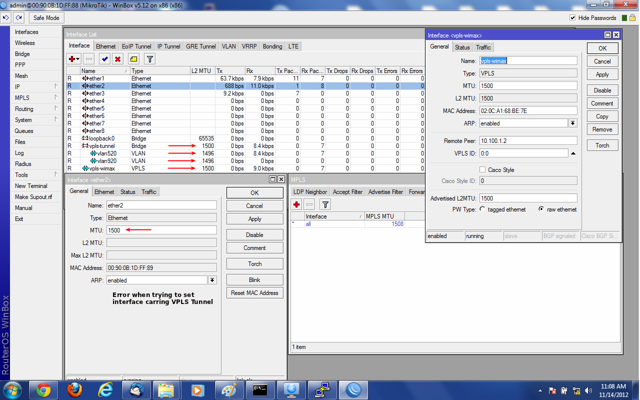

Ok, I seem to have my VPLS Tunnel up and running and VLANs operating over the tunnel. If I connect a laptop to access port on switch 2 and modem to access port on switch 1 (both vlan 520) I can pull DHCP, and browse pages, send email, etc. However, pinging the other side of the /30 I do get packet fragmentation. This forum post http://forum.mikrotik.com/t/vpls-having-problems-passing-traffic/56850/1 talked about changing the MTU on all LDP interfaces. I’m not entirely clear on what all the LDP interfaces are. I assume (I know, don’t… so I ask), the physical port which carries the VPLS and VLANs (ether2), the MPLS interface, and the VPLS interface. Does this also include the Bridge interface? Or do I have it all wrong. Could you direct me to the interfaces I need to change? BTW, when I attempt to change the MTU on the physical interface ether2, I get an error. I’ve included a screenshot to visualize what I see. Thanks for any help you can send my way.
[admin@MikroTik] > ping 10.100.1.2 size=1526 do-not-fragment
HOST                                     SIZE TTL TIME STATUS
                                                        packet too large and cannot be fragmented
10.100.1.1                                576  64 6ms fragmentation needed...
    sent=1 received=0 packet-loss=100%
[admin@MikroTik] > ping 10.100.1.2 size=1516 do-not-fragment
10.100.1.1                                576  64 1ms fragmentation needed and DF set
[admin@MikroTik] > ping 10.100.1.2 size=1496 do-not-fragment
10.100.1.2                               1496  64 0ms
    sent=2 received=2 packet-loss=0% min-rtt=0ms avg-rtt=0ms max-rtt=0ms
