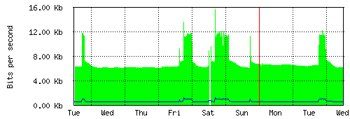

Ok, I have a music studio that is monitored by a network attached webcam and I would like to trigger a script on the MikroTik router if someone enters the room.

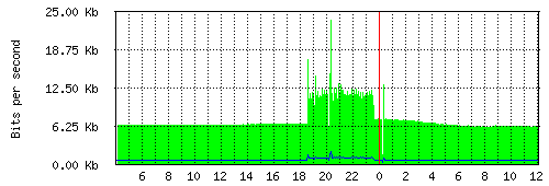

The cam uploads a picture every minute to display the current image on a website. If the sensor of the cam discovers some activity in the room it starts an upload to an ftp server to keep the pictures during the activity. I already made a queue (see screenshots attached) to see the usage of the studio.
As you can see there is always a little peak at the beginning of the activity. This is because the cam also uploads the last 5 pictures before the activity is discovered. There are also little outtages which are caused by the weak 3g signal at this place.
I would appreciate if you can give me a hint how to build a script that triggers an action (like sending an email or playing a sound on the router) when someone enters the room based on the queue (or some completely different idea). Maybe there is also a similar script that I did not came across with my search.
