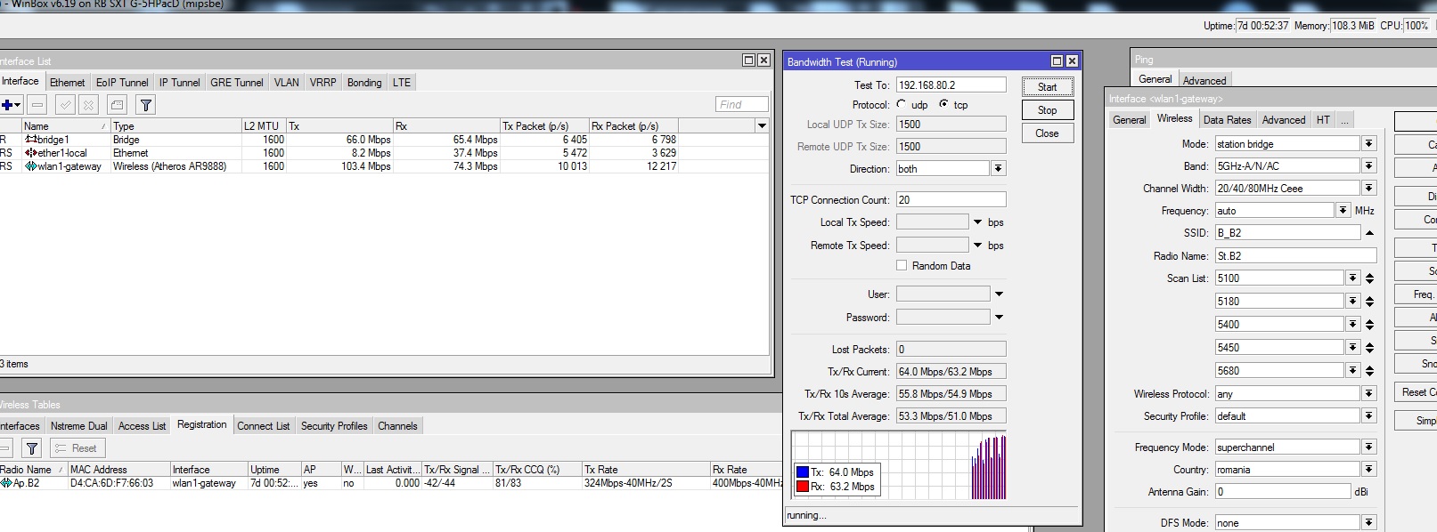

Here is my btest between SXT Ac limited by the cpu. In real trafic I’ve seen about 220mbps TCP in 40Mhz.
