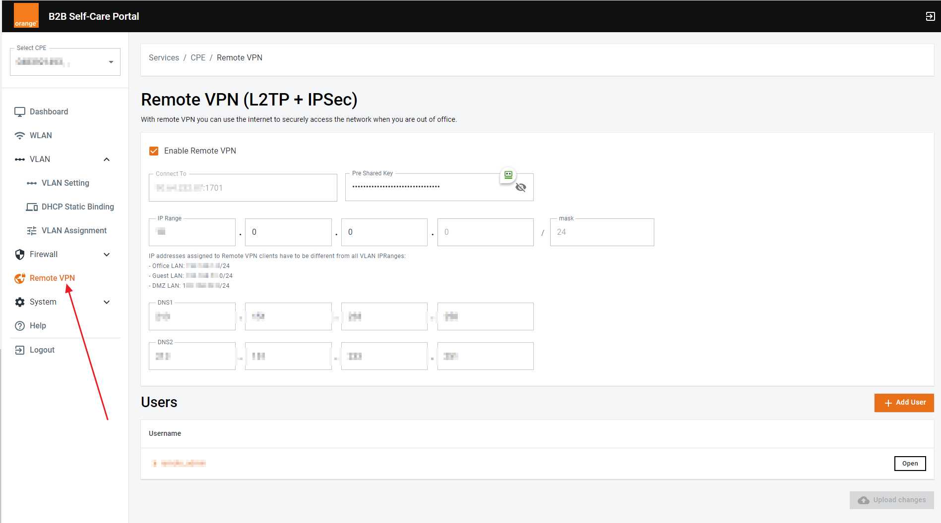

I am trying connect to Microtik hap ac3 by Orange Slovakia. They used limited webadmin access
I have Remote VPN enabled and configured, PSK generated, user defined.

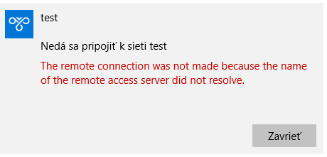

But when trying connect from Windows 10 obtain this message:
The remote connection was not made because the name of the remote access server did not resolve
What you masked in Connect To field looks like numeric address, so if that’s the case, the message is weird, because there’s nothing to resolve.

OK,
I am understand, but how can I solve this? IP address and port was entered automatically by ORANGE config system and is not possible change it, is grayied an unmodificable. How can I connect to VPN by IP?

See it looks like IP even with a masked pattern.
This is vissible public static IP address of my client and port was entered automatically by Microtic Orange autoconfig I think

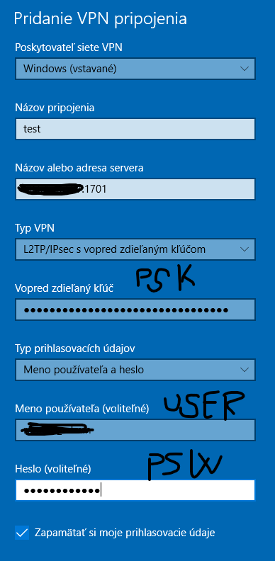

Yes, So what did you set in the L2TP out in the Windows client?
remove “:1701” from the client try if it can resolve it.
what is that you masked again in connect to. is it a name like google.com or is the public IP the same as your B2B portal?
