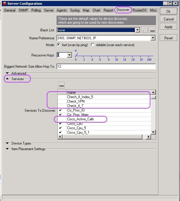

  1. You must know, there are some situations when probe is true in a lot of cases, but it should not be autodiscovered. The only one example of it: you made a probe (of a function type) which checks interface index 1 and, in case it’s down, sends alert with interface description. This probe should be never autodiscovered because to many devices have interface index 1, and you do not need to check every interface index 1.
    In a such a case there is a solution. Just look at picture

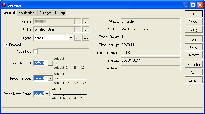

It shows “Wifi device down” which doesn’t makes sense since totwifiusers is 0 at that point.
I put [totwifiusers()] on the device label of both a “down” and “up” AP, on the down AP totwifiusers is “False” as it should be and on the AP that is up with zero users totwifiusers is “0”.

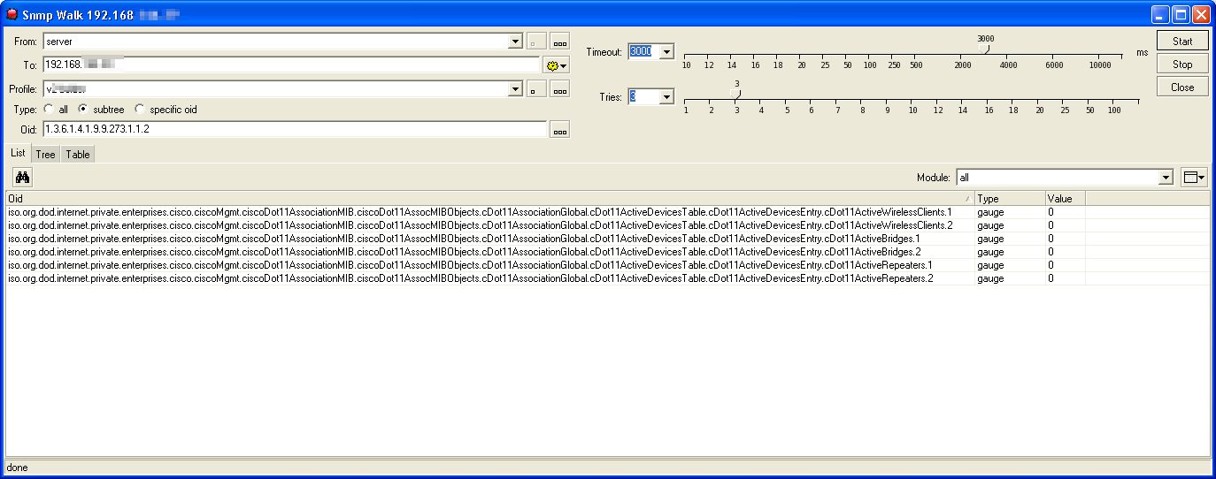

I suppose SNMP object cDot11ActiveDevicesTable with OID 1.3.6.1.4.1.9.9.273.1.1.2 becomes empty when there is no wireless client on access point.
You can check if anything is returned while snmpwalking on subtree at 1.3.6.1.4.1.9.9.273.1.1.2 when there are 0 clients registered.
You can modify the probe to show 0 when empty array is returned.
Here is the SNMP walk showing 0 in the relevant OIDs.

To break down exactly what is happening when I don’t add 1 the first IF on the error line “if(totwifiusers()<>“False””… is working out to be true. So at that point the probe fails if there are no users connected to the AP.
Here you can see a device with 0 users on it, I put labels on the devices to see the values being returned.
On the top AP you can see “totwifiusers” vs the actual “Num users OID” and in the lower AP that is offline you can see totwifiusers is correctly reporting false and the device shows down.
