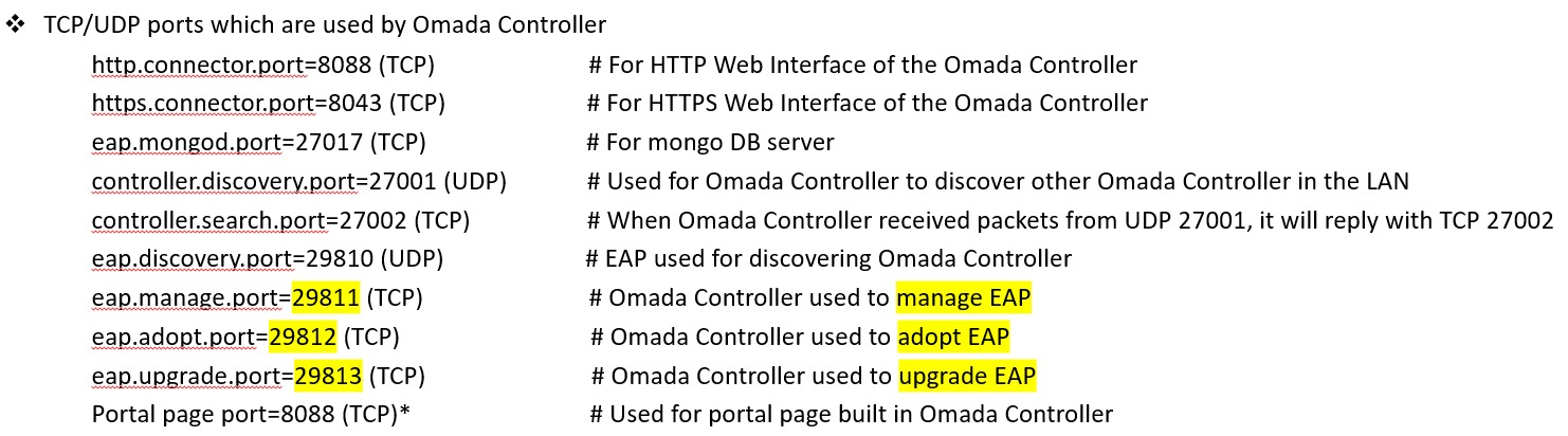

My Mikrotik RouterBoard model is the CCR1036-12G-4S. I have a TP-Link OC300 controller and TP-Link access points with different models. I need to open the following ports on the Mikrotik router: 29811, 29812, 29813, 27002, 27017 (TCP), and 27001, 29810 (UDP) to ensure uninterrupted communication between the TP-Link controller and the Wi-Fi access points. Please note that I have a hotspot configured on the RouterBoard.
The issue I’m encountering is that the controller can discover the access points, but the adoption process takes an unusually long time when using the OC300 controller with the Mikrotik RouterBoard. Strangely, when we replicate the same setup with the same devices on a simple network without the Mikrotik RouterBoard, the communication works perfectly and is established within a few seconds.
Any assistance or advice on resolving this issue would be greatly appreciated
