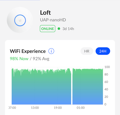

The network has been rock solid since reverting back to router mode and removing the Mikrotik device. I don’t know how Ubiquiti calculates its WiFi score, but the stability is evident in the graphs from the two access points.
I hope I the router won’t go to waste but I’m not sure yet how to diagnose what’s going wrong.
