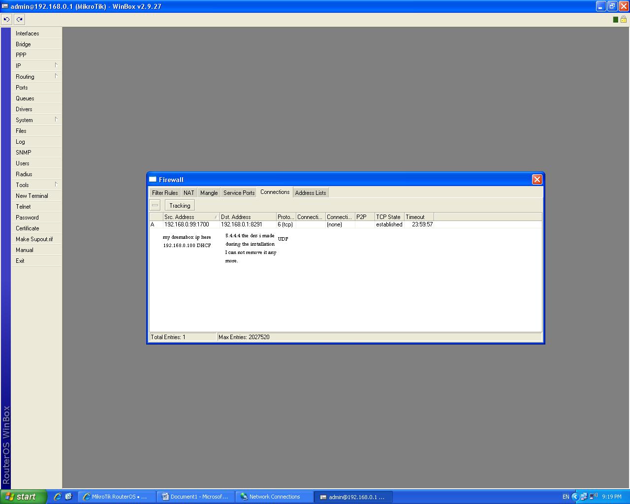

The bad thing is that I have a DreamBox satilliate with internet sharing. Does not work any more with MT also torrent azureus. I think it is related to the ports.

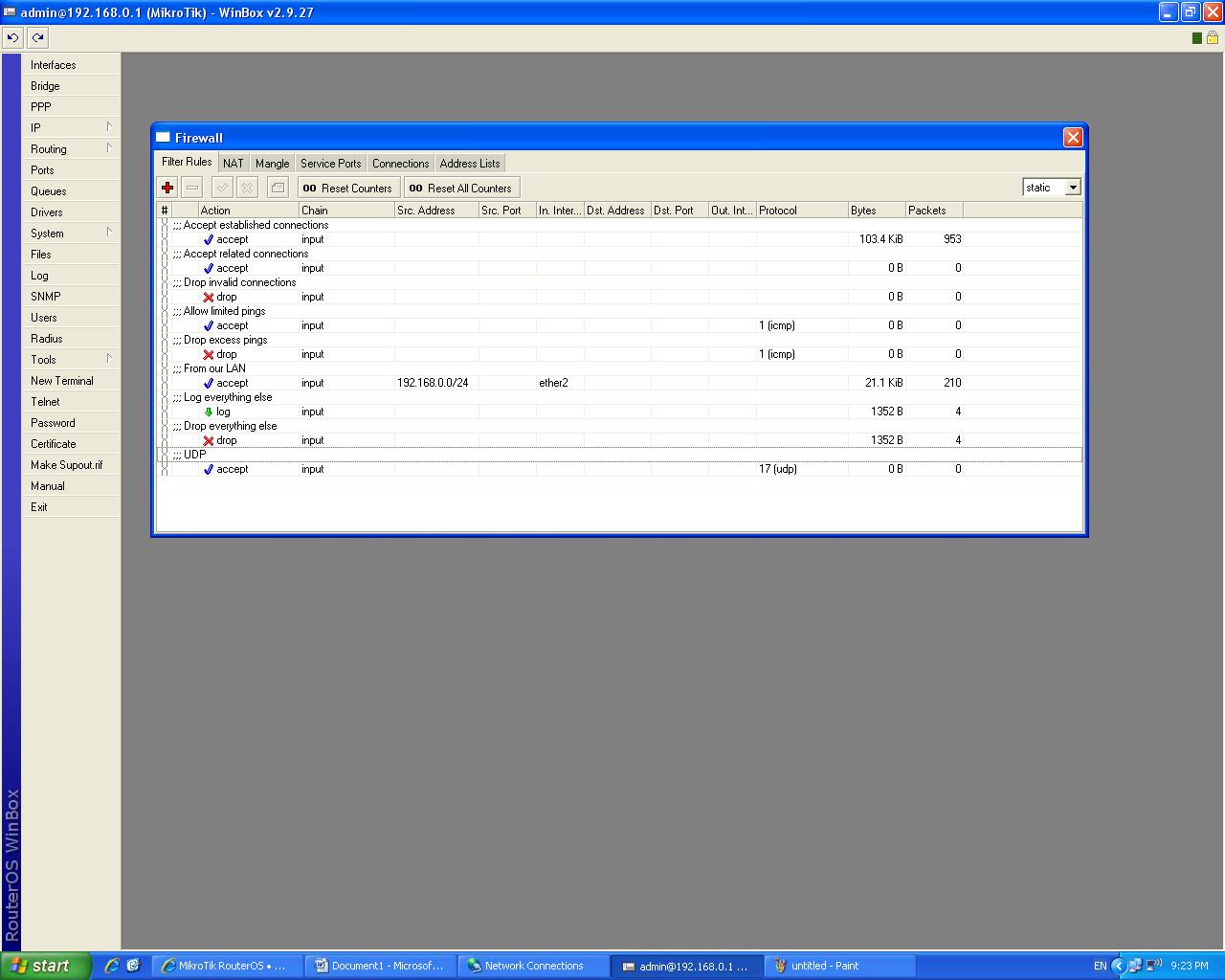

The firewall setting I have is attached as pictuer 2. The connection which shows how my dreambox connects to a dns 5.4.4.4 I made during installation but cannt remove I can not see it under ip \ dns setting I can see my ISP dns.
You might get past some limitations of nat-ing by enabling upnp in mt box. Without allowing to disable external interface. :slight_smile:
I will try that thank you.
