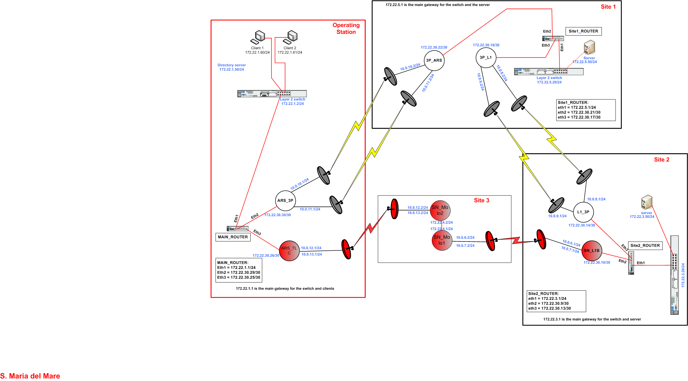

We have created a network like enclosed picture.
Red circles are RB433 boards with two wireless cards, ROS 3.22.
White circles are RB433 boards with two wireless cards, ROS 2.9.51.
Red antennas are dual polarized antennas, 29 dBi.
What we call “Routers” in the picture are RB450 boards with 5 ethernet ports, ROS 3.22.
We created a full OSPF network, with MD5 authentication and network type=point-to-point.
Routers have redistribute default routes activated.
The “red” path cost is less than the other one, so data from server in site2 is sent generally through this path.
