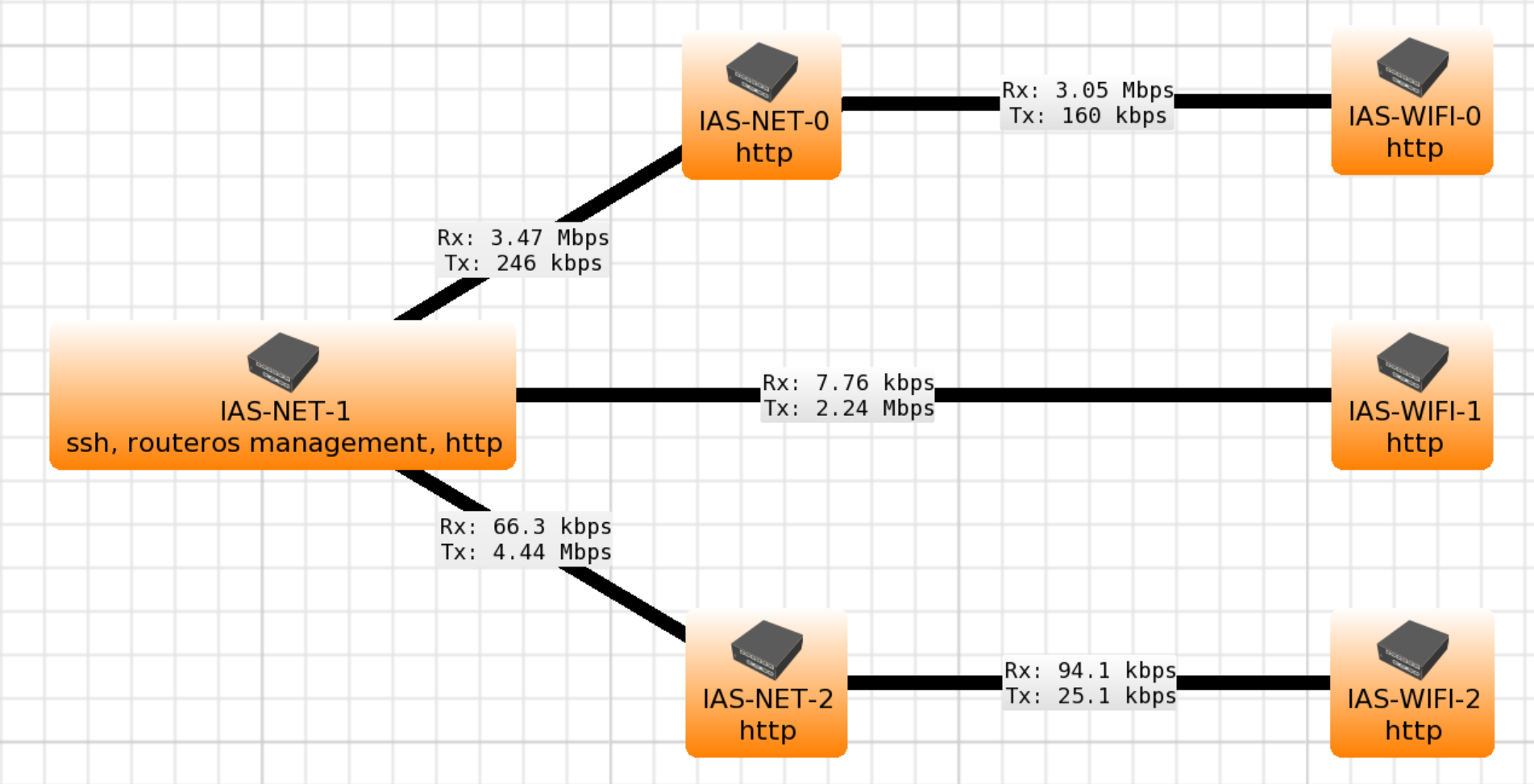

My home network consists of:
hex poe - acting as router/gateway/firewall/CAPsMAN
2x hex - acting as bridge with vlan filtering
3x audience - acting as CAPs controlled by hex poe
Below is the simple diagram of how they are connected:

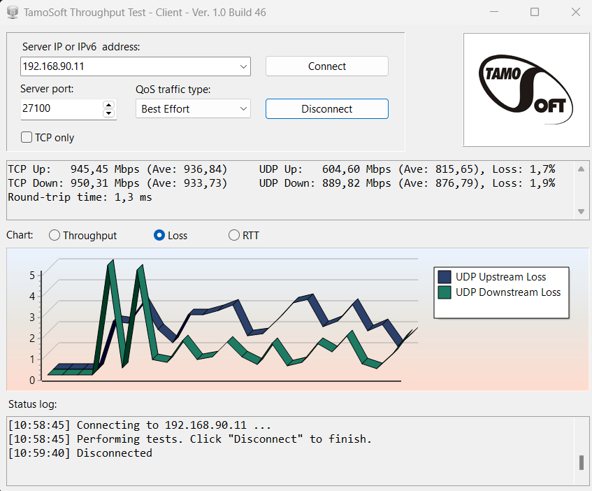

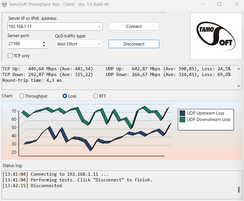

The performance issue I’m trying to narrow down is mostly visible on WIFI clients, but it seems there is something off with the wired network as well, even though it’s not noticeable in everyday use, without looking at network stats. Tests performed with Tamosoft Throughput Test gave me following results in below 3 scenarios:

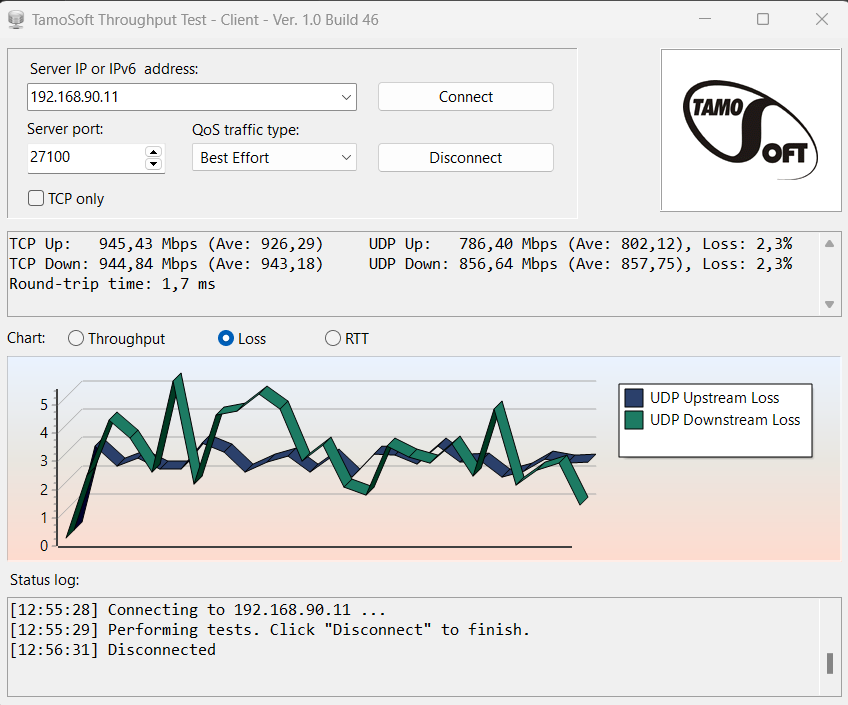

a) Server and client on 192.168.90.0 network - speed above 900 Mbps, occasional single digit % packet loss

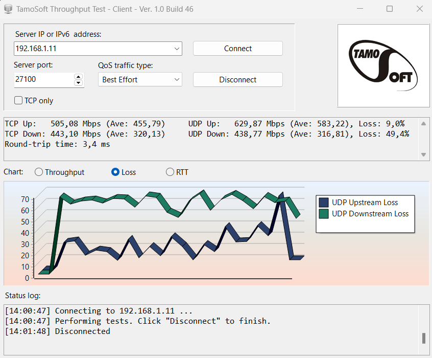

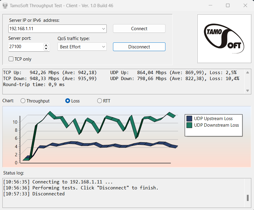

b) Server and client on 192.168.1.0 network - speed above 800 Mbps, frequent single and double digit % packet loss

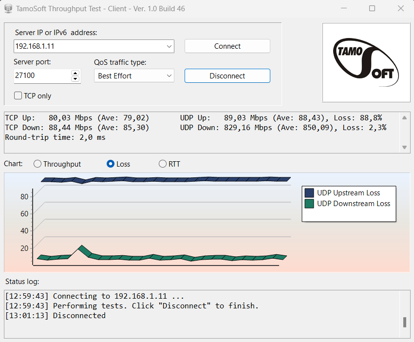

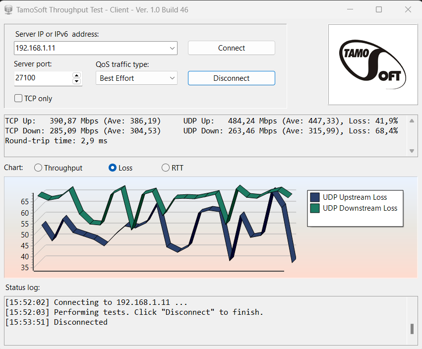

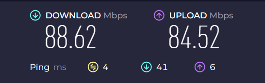

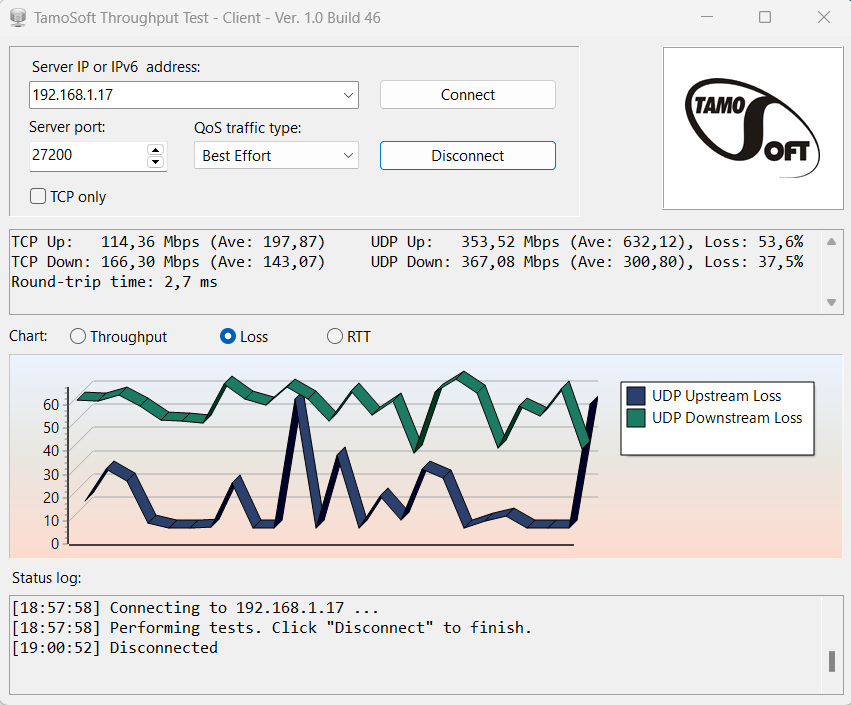

c) Server on wired and client on wireless 192.168.1.0 network - speed below 100 Mbps, consistent packet drops above 90% :confused:
So, I clearly broke something big time when introducing vlan setup but I’m not sure where precisely I went wrong. I suspect some default (or lack of) routing settings, or misconfiguration of firewall.

As the laptop has physical NIC handling untagged traffic and virtual NIC configured for tagged vlan90 traffic (similarly to the PC running Tamasoft server), I can perform tests on both 192.168.1.0 and 192.168.90.0 networks. Below are the results:
Untagged vlan10:
Tagged vlan90
The speeds are fairly stable and averages shown on the screenshots are reflective of the speed. I’m somewhat concerned about these UDP packet drops, though (however, it’s nothing near what I see when connected via WIFI).
Did you disable the 192.168.1.11 address on the test PC when you’ve told the client to connect to 192.168.90.11, or change it to some address in another subnet than 192.168.1.0/24 and 192.168.90.0/24? I don’t know the Tamosoft product so I want to be sure it does not take shortcuts - a “normal” application that uses the Windows networking stack would use the interface to which 192.168.1.11 is attached to send data to 192.168.1.x even if using 192.168.90.11 as the source address in the packets.
Because when both the wireless client and the PC are in VLAN 10, the traffic between them is forwarded at L2 so it never leaves the Audience, so the result of almost 1000 Mbit/s in both directions is possible. But when the PC is in VLAN 90, the traffic from the wireless client must get from the Audience via the hEX Gr3 to hEX PoE, get routed from one subnet to the other, and go back to Audience. Since the Tamosoft thing seems to test both directions simultaneously, there is no way how the two 1 Gbit/s streams (192.168.1.x → 192.168.90.11 and 192.168.90.11 → 192.168.1.x) could fit into the same 1 Gbit/s capacity of the Ethernet uplink of the Audience. So here, I suspect that only the 192.168.1.x → 192.168.90.11 traffic takes the long path, but the 192.168.90.11 → 192.168.1.x one takes the shortcut.
Interesting. I didn’t consider testing across vlans. In my above test both: the PC acting as the Tamosoft server (192.168.1.11 / 192.168.90.11) and the test laptop acting as the Tamosoft client (192.168.1.x / 192.168.90.x) were connected to hybrid ports and got IPs from both network on their physical and virtual NICs. I assumed that the tests in this scenario would go through respective vlans depending on which “server” address I’d choose (and the speeds suggested that they did).
Anyway, I’ve now disabled IPv4 in the properties of the physical NIC of the test laptop and checked that it is now only assigned the 192.168.90.x address. Then I repeated the tests to 192.168.90.11 (no real change there as far as I can tell) and subsequently to 192.168.1.1 (which in this case became a cross vlan scenario).
Results are below:
vlan90 to vlan90 ( IPv4 disabled on “untagged NIC”)
vlan90 to vlan10 ( IPv4 disabled on “untagged NIC”)
Also, while during the first test the CPU on hex PoE remained between 5-9% during the second test it was regularly jumping to 30% indicating that in 2nd scenario the router had more work to do.

So coming back to wireless; below is the missing test where the PC running the Tamosoft server is connected to the ether2 on hex and test laptop is connected to Audience over WIFI (connection properties showed connection over 5GHz 866/866 Mbps).
Below is the test performed with the “server PC” connected to the ether2 on Audience and test laptop is still connected to Audience over WIFI.
There is only marginal difference in the average speeds in these two scenarios as far as I can see.
However, these speeds are still much higher than an external speedtest from the test laptop which is still below 100/100 Mbps (compared to ~600/600 Mbps over wired network).
What should I target next?
OK, these tests seem much more realistic to me; even though the difference is not big, it is surprising that the throughput is better when the server is connected to hEX Gr3 than when it is connected to Audience, but that may be related to interference unless you live in the countryside without any neighbors. Does /caps-man interface scan interface-name spawned on hEX PoE show any 5 GHz networks around except your other APs?
Now I would check that the link between hEX PoE and hEX Gr3 has established on 1 Gbit/s full duplex (again using /interface ethernet monitor ether1 once on hEX Gr3). If yes, I’d check whether any of the Ethernet ports of both the hEX Gr3 and hEX PoE is not linked at 100 Mbit/s - it’s a bit esoteric but that’s for later. If it is, I’d disable it if possible and try the speedtest via internet again and also a test from a wireless client to a server connected to ether2 of hEX PoE, both within VLAN 10 and when only the address from the .90. subnet is up on the server (so that we could compare the “bridging” and “routing” performance).
First of all you were right in searching for any 100 Mbps ports. I was pretty certain I won’t find anything as I checked the negotiated port speeds before, but there is was: the connection between hex (ether1) and hex poe (ether 3) was showing 100 Mbps :astonished: I disconnected it and connected again and it’s now showing 1 Gbps.

With that change the results of the external speediest improved however the results of the test of internal network speed seems to be slightly lower than in the previous round (maybe it just shows its variability).
Tamosoft test (test laptop connected to Audience via WIFI, “server PC” connected to Audience on ether2):
Speedtest over WIFI:
Having said that it’s still quite far from the wired external speed test, And I’m not sure if that’s the best I can expect from 5GHz ac network? Or if I should be worried about all that pocket loss?
For reference, these are the results of the wired speedtest:
OK, so the test with the Tamosoft server connected to hex poe ether2 left me somewhat surprised. I don’t know what I expected, but I guess I expected that the results will be worse, or for some mysterious reason they will be better. I surely didn’t expect the mix. I performed the test twice with lot of time in between to make sure it wasn’t some momentary, non-replicable condition but both tests concluded with very similar results.
So here is the test where the Tamosoft server is connected to hex poe ether2 and the test laptop is still connected via WIFI to the same Audience as in previous tests (this means that there is now Audience, hex and hex poe between the client and the server):
What I find strange is that average TCP speeds are significantly lower here than in the previous test (where server was connected directly to ether2 on Audience) the UDP Down speed is slightly lower (but comparable) but the UDP Up average speed is significantly higher than in the previous test. While I don’t quite understand this, I think it indicates that the wireless connection is not the main influencing factor here as in both tests the client is connected to the same AP, is in the same distance from the AP (less than 1m actually) and is subject to the same interference.
Anyway, thanks sindy for your insights so far. You already identified the reason behind the sub 100 Mbps speeds, and since then I’ve already noticed this issue twice: first on the link between hex poe and hex, and later on the link between hex poe and other Audience (to be clear I checked that link after your initial post and it was 1 Gbps but later I found it reverted to 100 Mbps). I’ll monitor this some more to check if it’s something that happens regularly on my network.
On networks with any kind of problems (real or perceived, e.g. packet loss or large RTT), TCP and UDP connections behave very much differently.
For UDP connections packet drop is fine and stats show high throughput with high packet loss. Usually throughput shown on Tx side reflects throughput of first link leg … Tx stack does wait for Tx buffers to flush properly … if there’s a bottleneck on link legs beyond the first one, then the nearer device has to drop packets which overflow the buffer. So receiving end shows thtoughput, achieved by narrowest bottleneck on the whole link.
For TCP connections packet drop is not an option, there are mechanizms which ensure packet delivery (retransmissions) and to avoid excessive triggering of those mechanizms, there’s Tx window size which effectively reduces rate of transmission (trying to reduce throughput below the packet drop threshold). Since they’re driven by feedback from receiver, these mechanizms reflect conditions of the whole link between transmitter and receiver (all legs) and sometines also the reverse direction (which can be even more important in case of very asymmetrical link legs or half-duplex link legs). Due to these (and a few other) reasons it’s very hard to achieve wire (or “wire” in case of wifi) speed using TCP connections … even on a perfect link one can expect to achieve results a few percent below full capacity.
I don’t know what exactly the results shown on screenshot are telling. I’m more used to iperf3 (I guess tamosoft adds a fancy GUI to iperf3 CLI and tries to make dispkay of results nicer, but along the way some important stuff gets hidden). Running iperf3 it’s possible to directly compare results from both ends (server and client) which allows to diagnose point of the probkem a bit easier. E.g. it’s not clear what “UDP up:” resukt means … is it end-to-end result, reported by receiver (server)? Or is it report from sender (client) … which then shows thtoughput of first link leg (wifi) which in turn means that there’s another bottleneck further beyond wifi which causes packet drop?
Iperf3 also allows to set Tx rate for UDP … setting it to values below expected bottleneck bandwidth allows to verify that packet drop is indeed caused by low bandwidth of a bottleneck rather than poor link leg quality (e.g. faulty UTP cable or noisy/congested wifi connection) which would drop random packets regardless the data rate.
