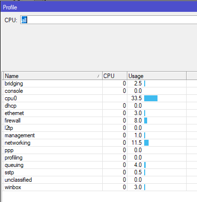

What process is taking up 30% of CPU? Seems high.

Don´t know what´s normal, does the attachment say you anything?

I tested the site I’m at. My networking process went to 40% on my RB750 but I got the full 100mbit. And I have a bunch of rules and a queue too with ipsec (speed test didn’t go through ipsec).
So now I think your cpu usage is normal since mine is the same and I get the expected numbers.
