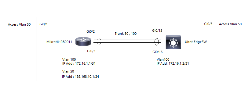

I have a some doubt on my configuration.
I’m trying to do a LACP between Mikrotik RB2011 ↔ Ubnt EdgeSW
2 Vlans that need to trunk over the LACP/Bonding.
Below is my diagram of the setup.
The vlan 722 is the transit between the 2 devices.
And the Vlan 50 is my management vlan that cross devices while L3 is terminate at the RB2011.
Can i know how the configuration should make at the RB2011?
Currently , i’m putting Vlan 722, 50 over the Bonding to make it work.
However, with this setup , i cant have the Vlan 50 to be used at the RB2011 under interface Gi0/1..
Please feel free to comment.
Thanks and appreciate any comment that share.

I’m aware that the LACP it is only 1.5Gbps , but i’m fine for that.
Just how to make Access vlan 50 to one of the port at Mikrotik rb2011 while having the trunk over to EdgeSw.

war3boy, you need to create a bridge and add the vlan50 interface and the Gi0/1 interface to it.
I am not sure about the performance of it, but it should work.
i tried that and it didn’t work…
