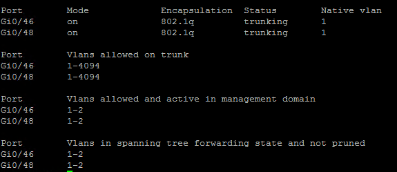

so here is the Cisco Interface in which i connected the Mikrotik:
simple stuff.

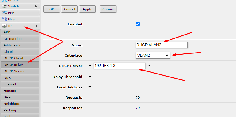

My DHCP is enabled only for VLAN2. I tried to set up the DHCP relay for the VLAN2 interface but it didnt worked…

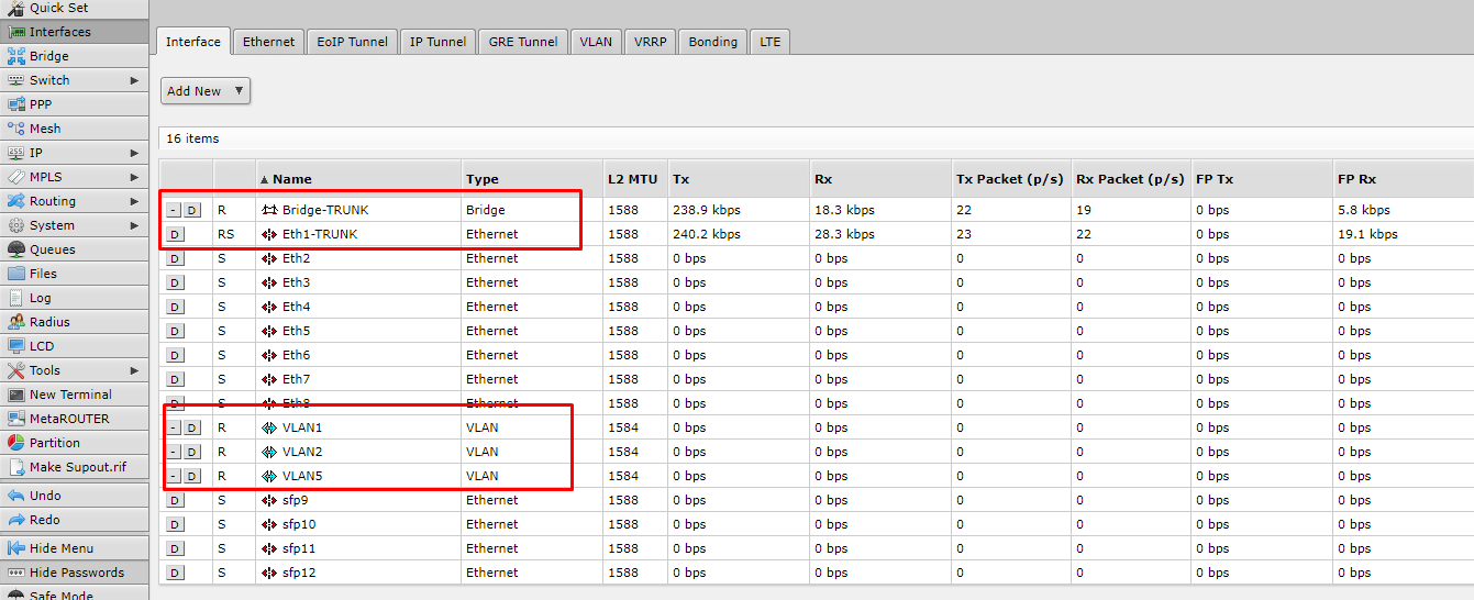

The interfaces

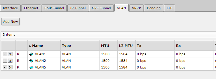

The VLANS

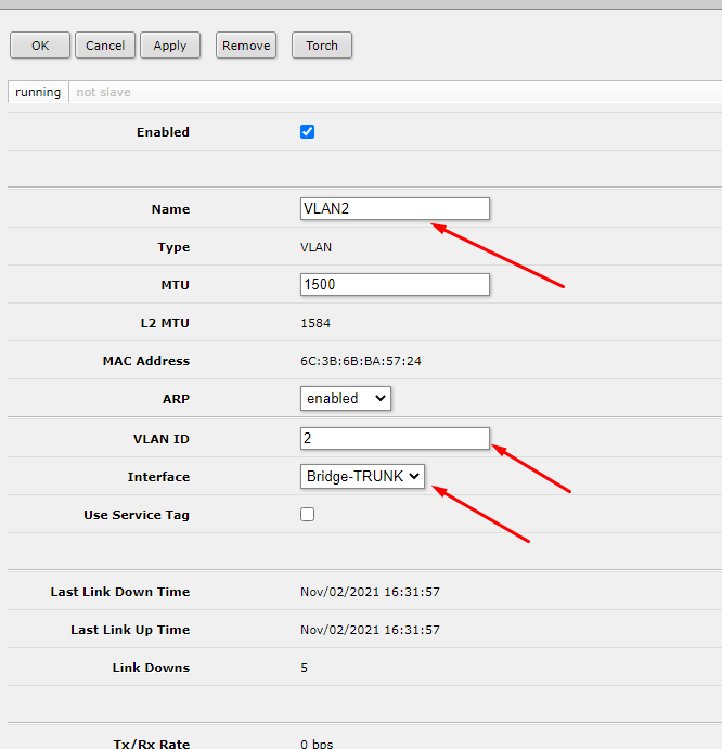

VLAN2

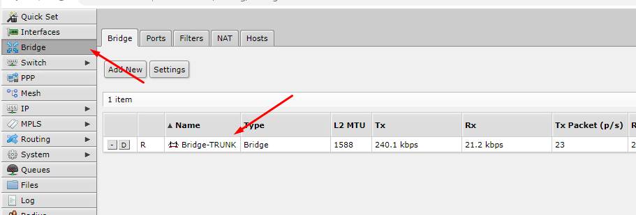

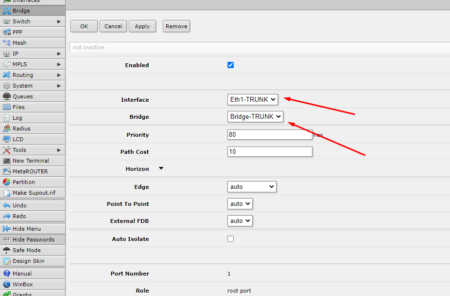

Bridge Interface
Bridge Port Connection

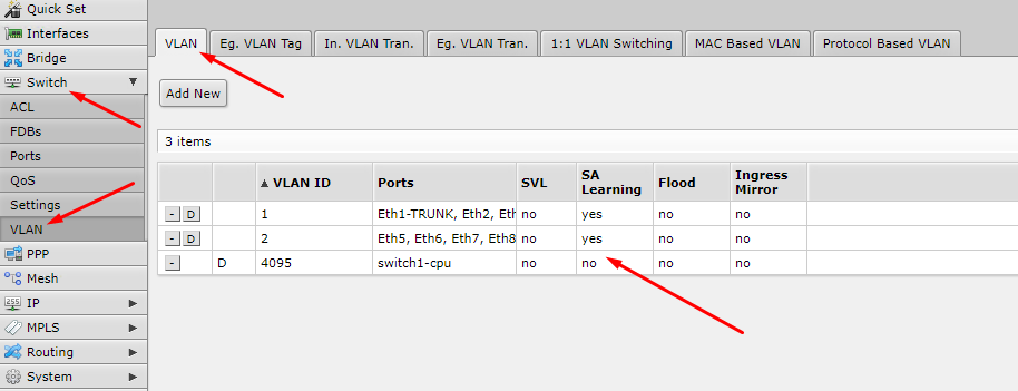

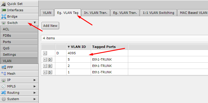

Here this is a test… dont know if this works, added the VLAN ID’s in Switch
I set the Egress VLAN marking

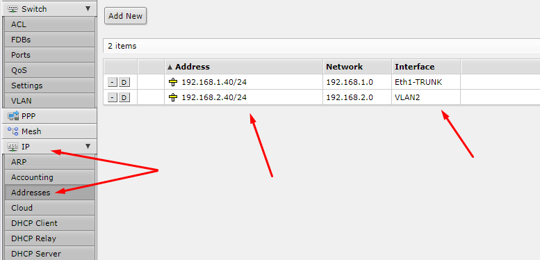

The IP assignment
The DHCP relay test i tried…
