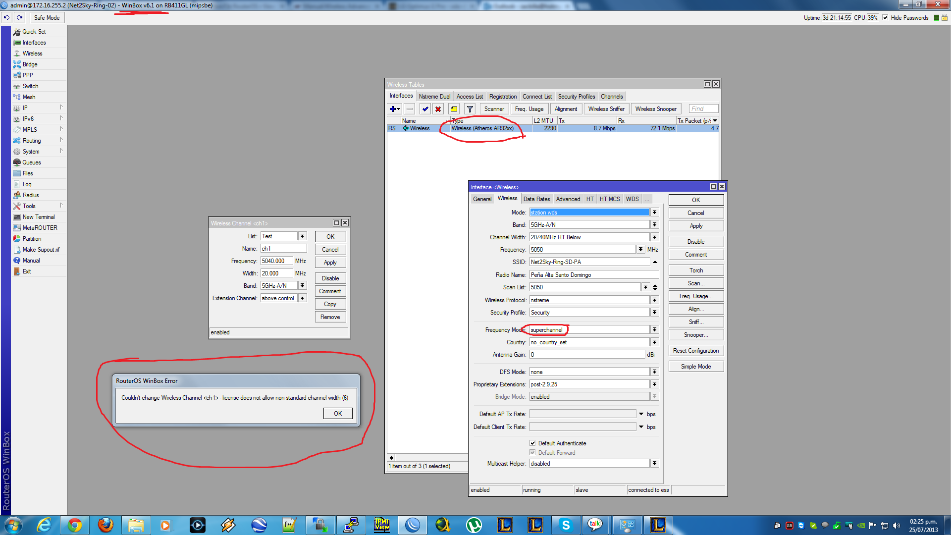

maybe this image helps more :slight_smile: i was trying to set to 30 and got this
Neilson is wrong here. This feature requires a special license, you must contact support and sign a form to get it.
hi, i did that but i got no answer, the last ticket was: 2013071366000084 and 2013062666000123 i sent the file to support but i got no answer on the second ticket “2013071366000084” can i send you a pm with the scanner signed form?

Good to know that non standard widths (30MHz) do require this extra license.
For my information and future reference. Do we need to sign one form for the company and then we can just apply for superchannel license upgrades through the portal by importing the licenses for our devices? or do we have to individually contact support and sign a new agreement and apply singly for manual license for each device?

Say that you want to use custom channels, and tell your mikrotik.com account username.
