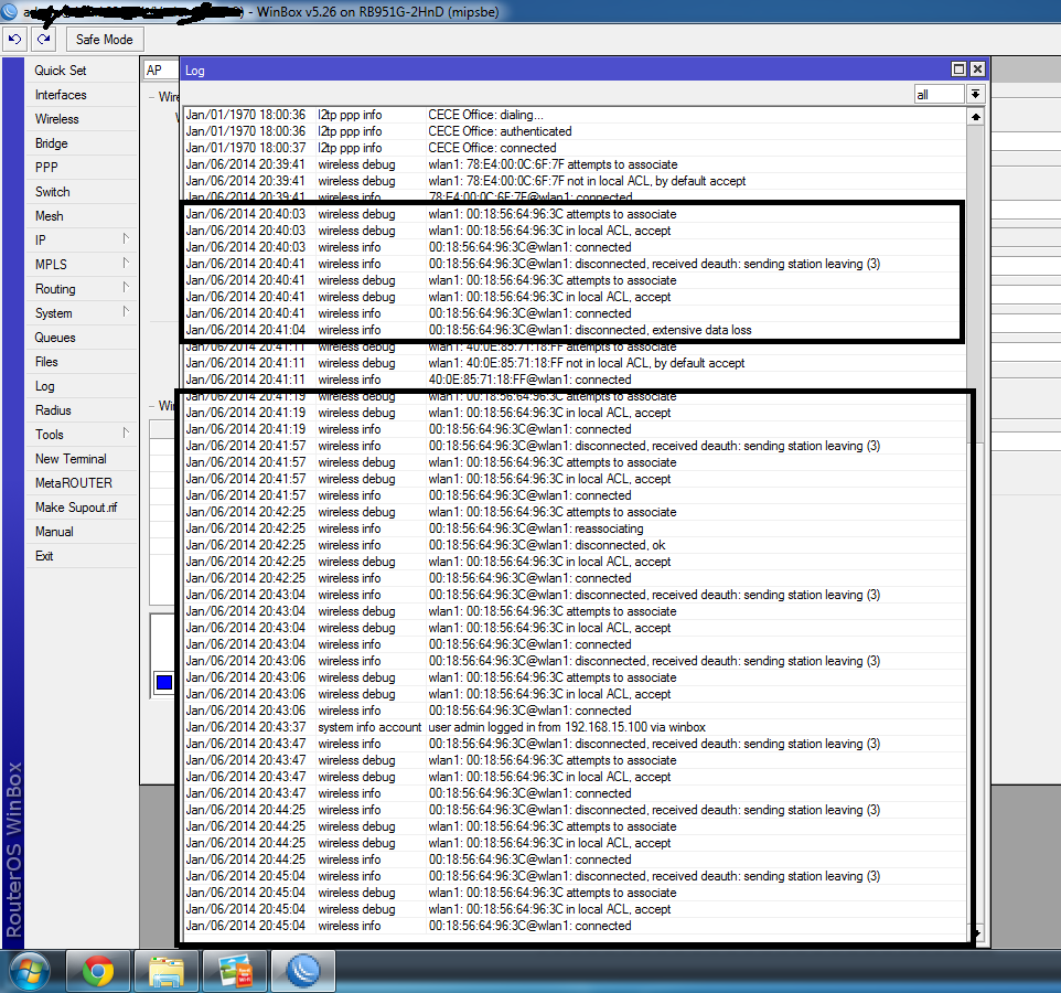

I followed the instructions from Eye-Fi. Initially, the card would error “DCHP timeout” (from Eye-Fi they were saying the DCHP server was not assigning an IP address). Throughout testing, I was able to see the MAC address of the card trying to access the router, but the DCHP server never assigning an address.
Attached is a screen shot of the log file. I am not sure how to download the log from the router.

Looks like client is asking to disconnect because of some power saving or similar. Is the DHCP server working? Can any other device connect to this AP ?
