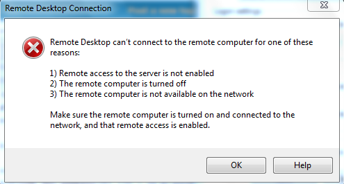

but when I try to connect to the computer by using the Remote Desktop I get error
why is it?
can someone explain me what is the mistake?

still not working
this is what I have now
0 chain=srcnat action=masquerade to-addresses=0.0.0.0 out-interface=ppp-out1
1 chain=dstnat action=dst-nat to-addresses=10.0.0.220 protocol=tcp dst-address=91.135.1.10
in-interface=ppp-out1 dst-port=3389
I can see that there is a “movement” in the rule ,but I still get error
