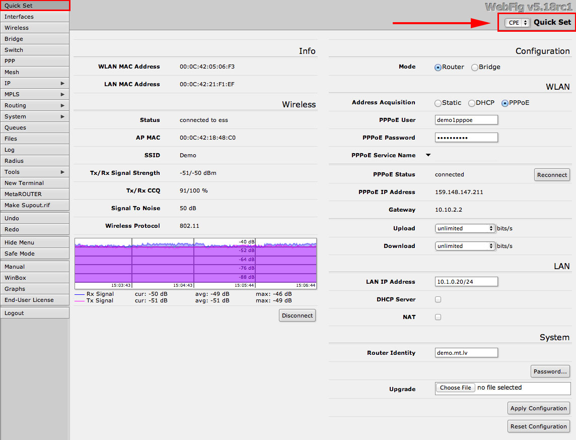

in Groove we have the Quickset which will quickly set your router up for this task. Open the IP address from the LAN side, and it will launch Quickset configuration page in your browser. Choose the option to reset the device. After that is done, simply choose “CPE” from the dropdown, and the device will be as good as done. Just IP and encryption settings will need to be set there.
Wellllllllllll, how easy is that normis??? Thank you, in Australia we say, “I owe you a beer”.
I had to upgrade to 5.17, (your screen showed 5.18rc1). THEN and only then did I see Quickset. Or was/is there a bug in 5.11?
All works OK, will go through the .rsc file to see any differences I may have missed.
BUUUUT, have now lost the signal strength lights??? Yet have good connection strengths. Had the lights before upgrade.
Have probably 50 odd Bullets in service, much more convenient than rb’s in enclosures etc, so will see how these go now. Always liked ROS over AirOS anyway.
It is really great to see you got it working. Yes, Quickset is a new feature - it allows you to configure devices with a few clicks. We only added it recently (RouterOS v5.14). We plan to add more features, and more modes (in addition to CPE/AP). I will check why you lost the signal LEDs, will get a Groove to test it.
