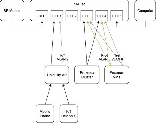

So after years of using single LAN for all devices I decided to separate them with VLANs. I have hAP ac so after checking some tutorials I decided to give it a try. Here is my target setup:
Basically my mobile phone, computer and proxmox servers should use 192.168.1.0 network, IoT devices 192.168.2.0, proxmox VMs either 192.168.5.0 or 192.168.6.0.
I’ve created following basic configuration - it is enough or I should add something more? I’m pretty sure I need to set something under /interface ethernet switch port but I’m not sure what exactly should I put there :frowning: Of course i will prepare corresponding firewall rules later.

/interface ethernet switch vlan
add independent-learning=no ports=ether1 switch=switch1 vlan-id=2
add independent-learning=no ports=ether3,ether4 switch=switch1 vlan-id=5
add independent-learning=no ports=ether3,ether4 switch=switch1 vlan-id=6
# I'm not sure about this part
set ether1 vlan-mode=secure vlan-header=add-if-missing
set ether3 vlan-mode=secure vlan-header=add-if-missing
set ether4 vlan-mode=secure vlan-header=add-if-missing
add address=192.168.1.1/26 comment=defconf interface=bridge network=\
    192.168.1.0
add address=192.168.2.1/27 interface=vlan2 network=192.168.2.0
add address=192.168.5.1/26 interface=vlan5 network=192.168.5.0
add address=192.168.6.1/28 interface=vlan6 network=192.168.6.0
add address=192.168.1.0/26 comment=defconf dns-server=192.168.1.5 gateway=\
    192.168.1.1 ntp-server=192.168.1.5
add address=192.168.2.0/27 dns-server=192.168.1.5 gateway=192.168.2.1 \
add address=192.168.5.0/26 dns-server=192.168.1.5 gateway=192.168.5.1 \
add address=192.168.6.0/28 dns-server=192.168.1.5 gateway=192.168.6.1 \

First mistake is mixing apples and oranges, once you have vlans, remove subnet from bridge so it does no dhcp, much less confusing.
Bridge ports are wrong
Not sure why you are even touching ethernet switch settings of any ILK be it ethernet switch vlan or port ???
Clearly you chose the wrong youtube article. :-0
Another pointer… the config is all interconnected, posting only part of the config is not a recipe for success.
Certainly should have the default set of firewall rules on the config before attaching anything to the WWW.
/export file=anynameyouwish (minus router serial n umber, any public WANIP information, keys etc. )
Looking at your config, it looks like you have followed or are applying what I see as “v6” logic to this. Nothing wrong with that at all unless you are running v7 or you want to get this done this year.
To cut a very long story short(er) - Once you go VLAN, you drive those VLAN’s from your bridge menu, in Bridge > VLANs you’ll find you can set tagged and untagged ports per vlan as well in ports you can set pvid for untagged traffic (not that you need to as your additional networks will all be tagged).
Couple of advisories though:
ALWAYS use safe mode, when you think you have VLAN configured and you turn on vlan filtering in bridge as it is needed - first time round you rarely have it configured well so safe mode will bail you out.
If you are tagging all other traffic, change your native vlan to something other than 1, it’s better practise to do this.
I would be tempted to run ether3 and 4 as untagged vlan 5 & 6 respectively, it’s an “easier” config to and your Proxmox setup will be simpler. You’re not gaining anything by having 2 ports with trunked network unless Proxmox is sitting on 3 networks, untagged and the 2 tagged?
