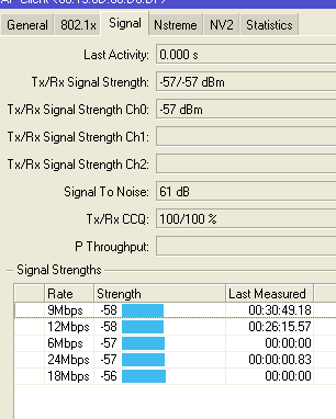

Ping Wlan interface on AP
Its Possible to get better ping.
