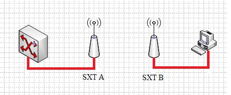

Tutorial - Connecting Two SXT's Together
I put together a tutorial for connecting two SXT’s together in bridge mode.

I’ve followed your instructions and couldn’t get SXT’s work in Station Mode.
When I configure it this way SXT A and SXT B could comunicate between, but I couldn’t reach Station device from switch.
Even if SXT A was in Station Mode directly on the switch, and SXT B was remote in Bridge Mode I could ping SXT B but not SXT A.
Until I switch SXT A in Station wds Mode. Then it worked.
I was wondering why I need to configure my P2P devices as WDS?
if you have bridge station mode then that was the problem - you can’t bridge station mode.
Try to use station-bridge mode or station-wds. Here are some info that might help you:
http://wiki.mikrotik.com/wiki/Manual:Wireless_Station_Modes
Thank you uldis,
It work now with Station WDS mode but please, correct me if I’m wrong, reading this, for P2P link I should use station-pseudobridge?

This tutorial is excellent and eliminates alot of the confusion for those of us that aren’t really good at using the CLI.
Note that one SXT is in BRIDGE mode.
The second is in Station Bridge mode.
Using this method you don’t have to use WDS.
