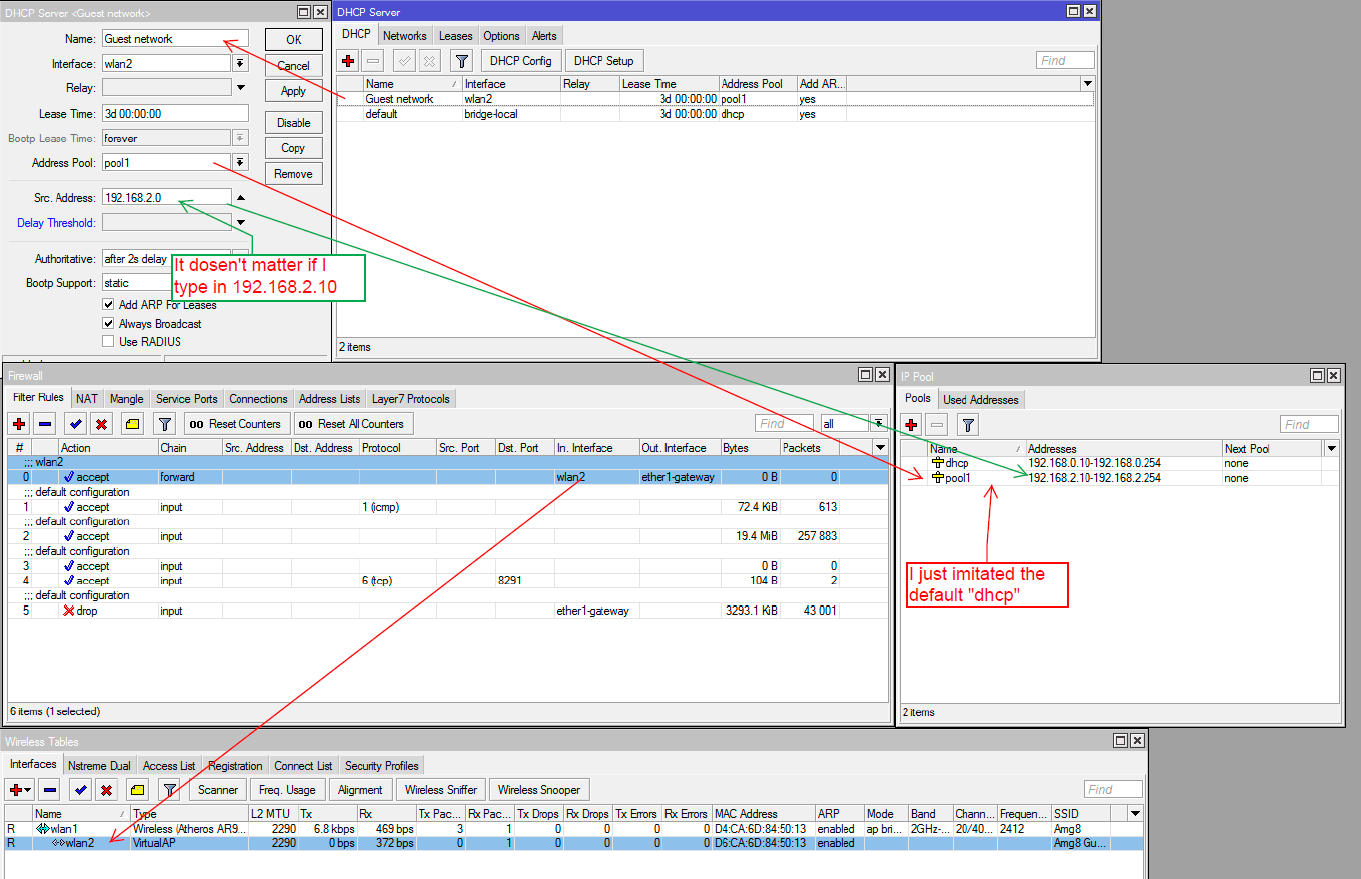

My goal is to have a separate wireless ap, on a separate network - a separate IP range, so guest can connect to the Internet without having access to my local network.
I did what you tell me to - and a bit more, collected from other instructions.
  1. I created a virtual AP under “Interfaces”, with wlan1 as “Master Interface” - I actually have no other option.
  2. I created a separate “Security Profile”.
  3. I created a new entry under “Address List”, with the wanted address (for example: my private (local) network is 10.1.1.1, and the guest (public) network should be 10.1.10.1) and bound it to wlan2 (the new AP)
  4. I created a DHCP server for the new wlan2 interface.
The result is that I can connect to the new wireless (wlan2), with the password from the new security profile. I get an IP, but the IP is not following the DHCP IP range for wlan2, but the standard (private) IP range. And there’s no actual connection out on the Internet.
As for the “Firewall Rules” part, I have no idea what to show you. I have not touched anything on that part.

You should create a new ip pool instead of an address list.
Use that ip pool for your WLAN dhcp server.
Of only internet Access is needed, probably your current Nat masquerade will do.
you have to allow the guest network to pass the router towards the internet and block access to your local network.
add chain=forward in-interface=wlan2 out-interface=.It can all be done more sophisticated, but this will do.

Now, I did what you said.
  1. I Created an “IP Pool” (pool 1), and bound wlan2 to it, under “DHCP Server”.
  2. I created the firewall entry.
Now, when my device try to connect, it is not accepted - I don’t get an IP address.
Under “IP Pool” I changed the original “dhcp” pool to point to “Next Pool = pool1” - it makes no difference as far as I can see…
Under “DHCP Server” the wlan2 is red - as if something is missing?
It would be nice if you post your config.
Do an export compact and post it here, much easier to see what’s wrong.
With this setup, I get an IP address in the given range. But no access to the Internet…
I think you can leave out the source address on the Rico.
You should however create a NAT arc-nat rule to masquerade your internal IP.
Well - I already tried that, without any luck.

Are you also giving a Default Gateway via DHCP and does your WLAN 2 interface have an IP address?
You also need some serious forward chain firewall rules.
