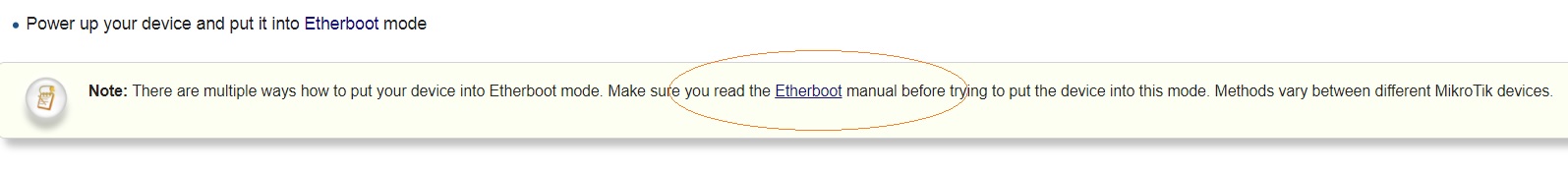

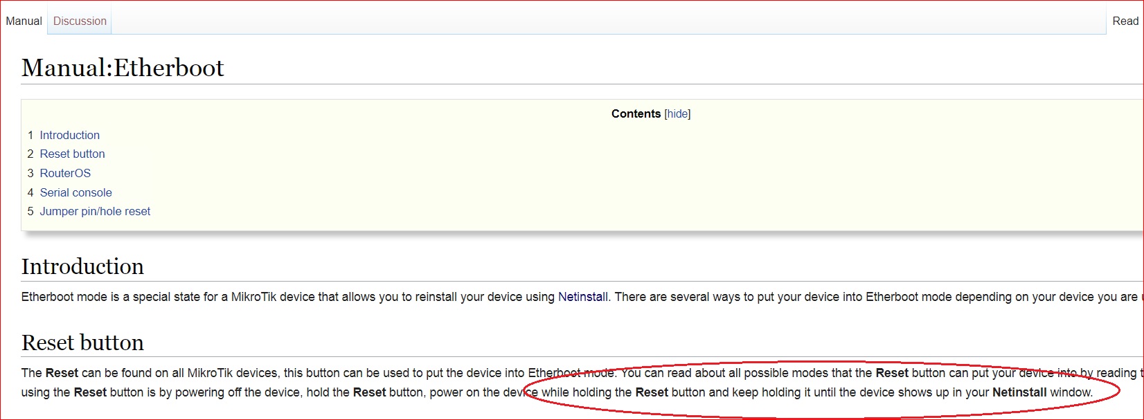

Thank you. Very helpful and the link (Recover a Broken Mikrotik Device) mentioned holding the reset button for 30 seconds or until the device shows up in NetInstall which helped a lot. It took me 25 seconds. I only saw 5,10 and 15 seconds posted on the wiki.
swerty, that information is in the wiki…
The note in the MT wiki that discusses the point at which you powerup the device with the reset button depressed…
Says make sure you read the ETHERBOOT manual (its a linked url)
From there its crystal clear LOL.
