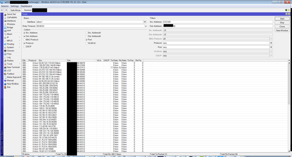

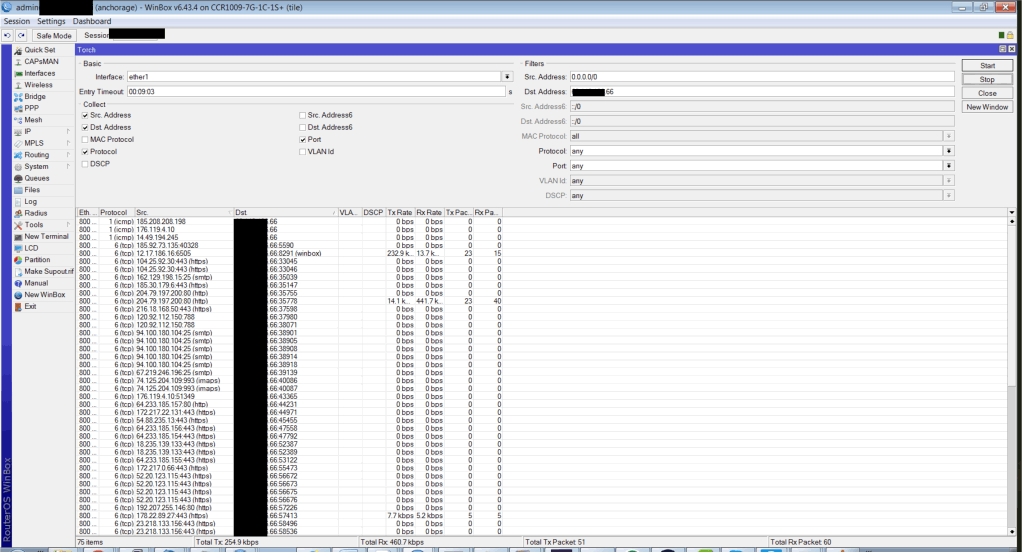

I have two CCR routers that have been upgraded fully to 6.43.4 and have the routerboard firmware upgraded also. Both units are still exploited. The are no config changes to the router, this is all transparent and going on the background. The way to spot this particular one is to look for people targeting your router port 64312. If your router is hacked with this, port 64312 will be OPEN. It is used as a proxy from the traffic I can see, SMTP and HTTP(S) and other stuff. I can watch with torch and see all the activity.

I have already submitted supout files for both routers and the response I got back from them says they didn’t read my message in the first place. “Check the proxy, config, etc”. The only way I know it’s active is the output traffic from it’s preferred IP address, and the fact that port 64312 is open. I can telnet to it and connect but it doesn’t say anything and disconnects when you send a line. I have two IP addresses on the router, the exploit only talks on the preferred IP. I have that blocked via the output chain in the firewall but can still reach the device and verify the port via the second IP address. If I remove the blocks connections pour in over 64312 and the router initiates a bunch of HTTP, HTTPS, IMAPS, and SMTP connections. The routers does not NAT any user traffic except for DNS port 53. So it shouldn’t have any of this traffic. It’s blocked via the output chain when it shouldn’t be there at all.

NOTE: Traffic showed on Torch is traffic “before” firewall. Torch shows all the traffic received on this interface. If someone tries to send traffic to a closed port, then it will still show up in Torch.
