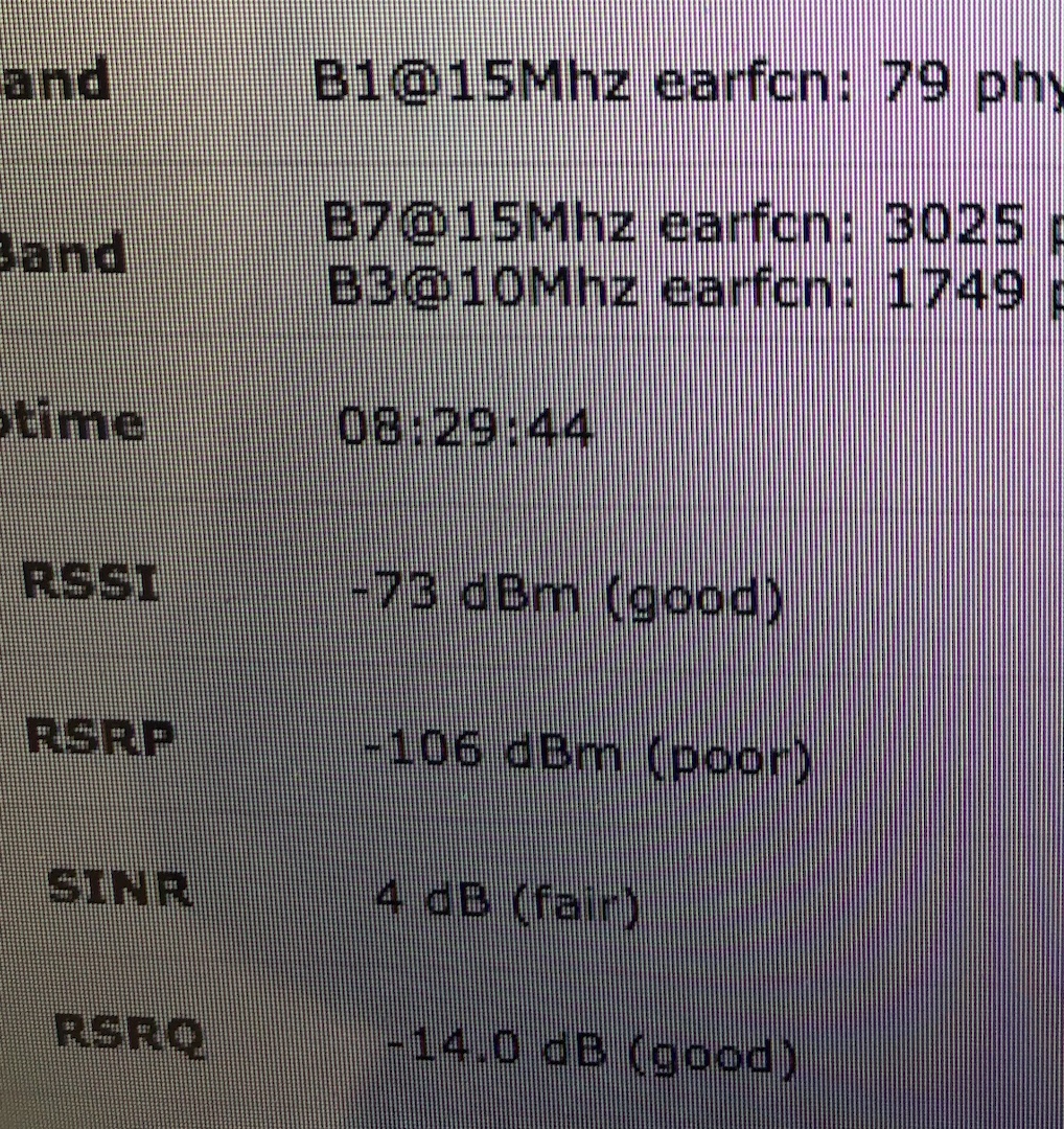

Go to interface/LTE. there is a status tab where you can see used bands
It is not about SIM, it is about tariffs and hidden terms&conditions.

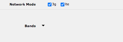

I’m attaching pictures of both mine and my neighbour’s bands used. Looks pretty much identical to me.
We’ve both got “Bands” not selected so going on with the defaults.

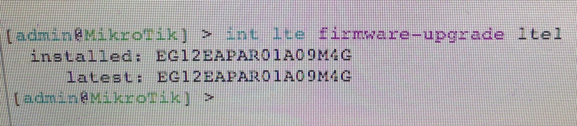

The firmware of the LTE module is update?
The last version is EG12EAPAR01A09M4G (at the date 06 Jul 2021)
for check only:
/int lte firmware-upgrade lte1
for upgrade:
/int lte firmware-upgrade lte1 upgrade=yes

So it seems that I’m using older LTE FW but surprisingly we can’t install EG12EAPAR01A05M4G_BETA0821 specifically
Neighbour on EG12EAPAR01A09M4G and nothing to upgrade to.
I’m on EG12EAPAR01A06M4G, can upgrade to EG12EAPAR01A09M4G
Yes, you can upgrade to latest version EG12EAPAR01A09M4G (at the date 06 Jul 2021)
