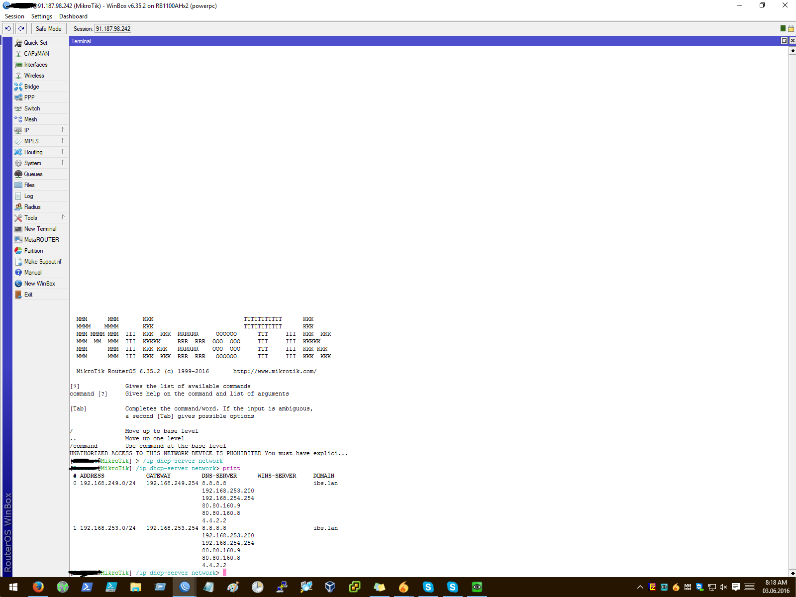

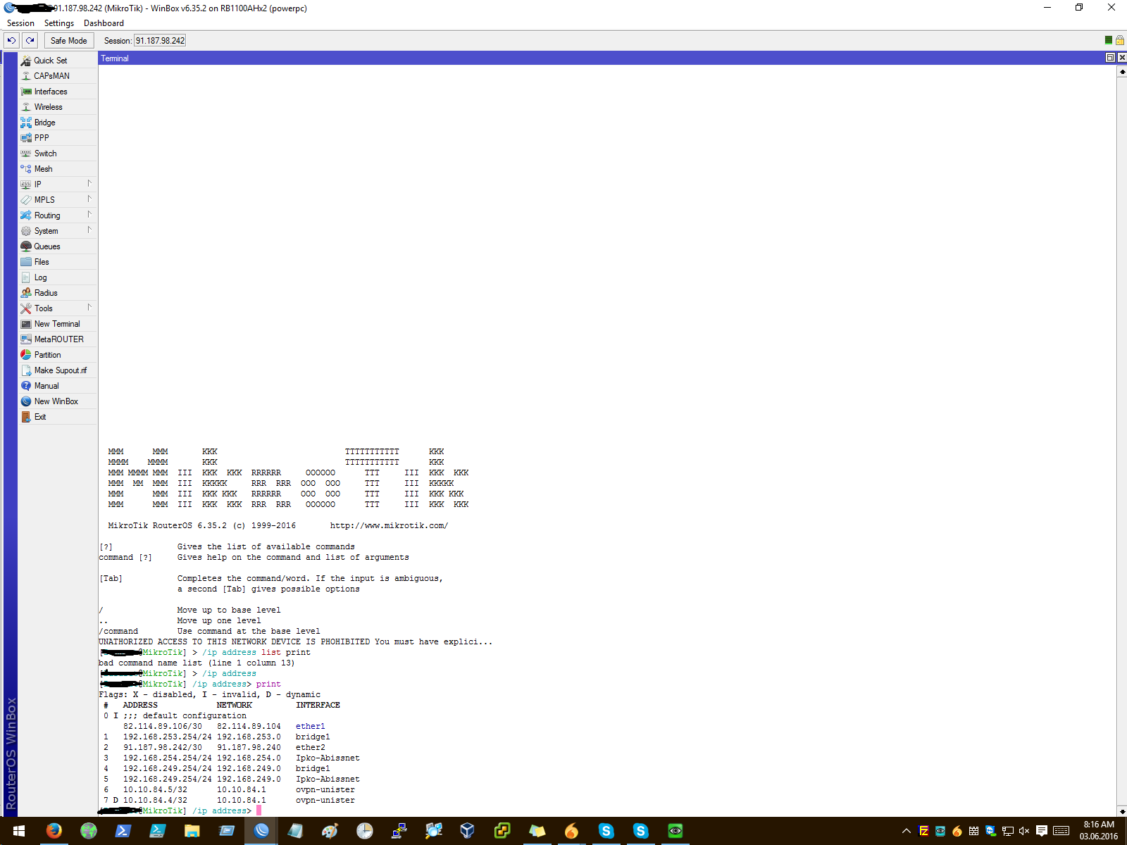

Please see the file attachment for my IP Address List and DHCP-Server List.
My Domain Controller have the ip 192.168.253.200 and my router have the ip 192.168.253.254.
Thank you for your help.
