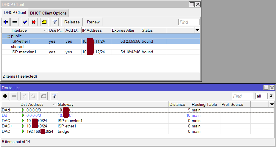

If you enable the second DHCP client temporarily, do both the default routes added dynamically via DHCP have the same IP address as the gateway?
Anyway, as you haven’t added a dedicated routing table, neither by creating a VRF (which needs a name of a routing table) nor manually, all the traffic would use the ISP-macvlan1 as the gateway interface even if you enabled the now disabled DHCP client attached to ISP-ether1. So your action=masquerade rule that matches on out-interface=ISP-macvlan1 sets the reply-dst-address to the IP address assigned via DHCP to ISP-macvlan1, but that rule only acts for outgoing connections initiated by hosts that are not on the pubwans address list. The other rule does not act at all because currently, ISP-ether1 is never the out-interface so outgoing connections from hosts on the pubwans address list are not src-nated at all.
So if your ISP does not check that the source IP address matches to the source MAC address, and if the addresses they assign you via DHCP never change, you can just change the rules in the srcnat chain from action=masquerade (which use the address associated to the out-interface as the reply-dst-address) to action=src-nat to-addresses=10.3.33.x (where you explicitly specify the reply-dst-address to be used for that connection) and let them both match on out-interface-list=WAN-pub; the one matching on src-address-list=pubwans would assign one reply-dst-address and the one matching on src-address-list="pubwans would assign the other one.
So I’d suggest that you try this first, as it is a relatively small change yet it may be sufficient. If it is not, because either the addresses change or the ISP checks the match between source MAC address and source IP address, we can implement the more complicated approach with an additional routing table and either a full VRF approach or just a policy routing within the “default routing instance”.

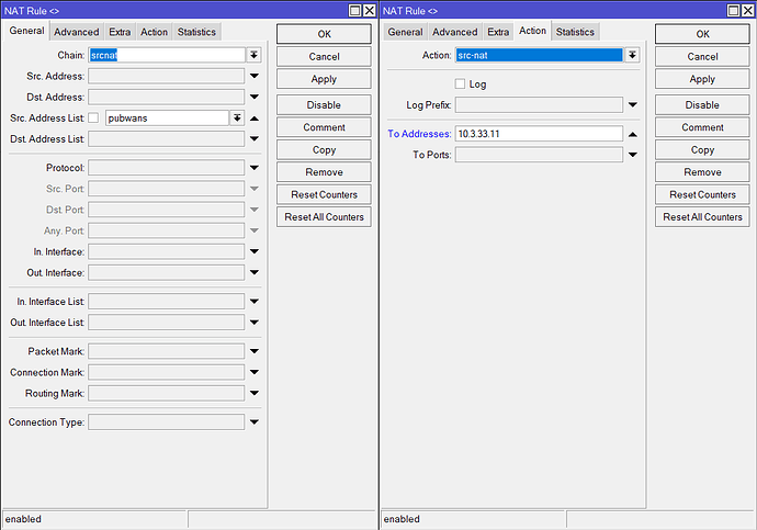

Other than that - since the gateway IP is the same, try the change of srcnat rules I’ve suggested.

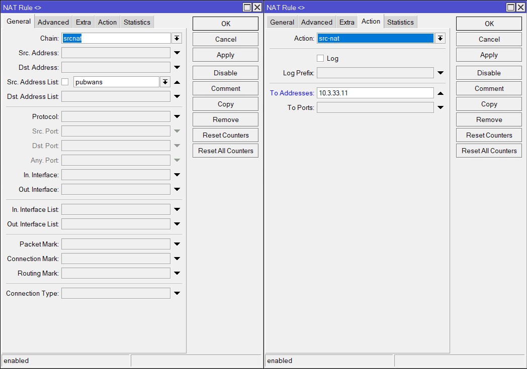

An here goes something that I don’t understand. When I just enable the second DHCP client on ether1, “the internet stops working correctly” - LAN PCs are not able to browse the internet in a reasonable manner. When I traceroute from my laptop (not on a pubwan address list) to some internet address, I end up on mikrotik as the only hop that responds (192.168.xx.1), but traceroute to the same address from the mikrotik itself works well. Also traceroute from a PC on pubwan address list does the traceroute, but when I try to go to infosniper.net, the page loads half and stuck - after a while it completes loading and shows the static public IP address. infosniper.net on my laptop (not on a pubwan address) also behaves stucky and then shows the shared public addres (which is correct).
It just behave “randomly”, as if the router tries both ways to the gateway in a random fashion. When I disable the ether1 DHCP, all PCs NOT on a pubwan address list goes to the internet without problem and the PC on a pubwan address list is completely without the internet.
Sniffing on WAN would tell you more about what actually happens, but now as I look at your screenshots again, it seems to me that something is rotten in routing - in RouterOS, not in your configuration. While the default route with distance=5 is marked as active and the default route with distance=10 as inactive (which is correct), the + signs in the leftmost column should be there for both routes to 10.x.x.0/24 (because indeed this subnet is reachable through both your WAN interfaces) whereas the + sign should not be there for the default route with distance=5 as there is no other route with same dst-address and distance in the same routing table.
What happens if you set add-default-route on the DHCP client attached to the macvlan interface to no and change the rules in srcnat the way I have suggested above (you can add my rules after your ones and then disable your ones so that you could return to them easily by first enabling them and then disabling mine).
What is happening is correct, which is why I wrote that macvlan is unnecessary. For this configuration, policy routing would be required. It will be simpler to give up on macvlan, use DHCP to get one address, and set the second manually.
Well, it seems to be working. I made the settings like this (disabled my masquerade rules and added this:)
Now the PC on pubwan list goes to the internet through static dedicated public IP address and others go through the shared one. I just had to hope that my ISP will not change “its own 10.x…” addresses. It did not happen for several (tens? of) years now, so let’s hope it will stay intact. My ISP probably (i think so) has hard-set reservations since he wants to know our MAC addresses (especially when we change our hardware). It’s kinda small ISP, not any big one. We even don’t have monthly fee for our static public dedicated IPv4 address :slight_smile:. (or is it possible to make a working script that will make the rule with the IP address got from DHCP server?)
It even works no matter whether I have “add-default-route” to no or yes on the ISP-macvlan1 DHCP client settings, but I left it set at no.
So now I can try to return those dstnat rules back and see if it will do its job.
And of course: thanks a lot.
