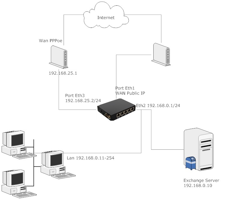

What is the best way to do this.
I need to send all the lan traffic… 192168.0.11-254 trhought the PPPoe connection.
I tried just using 0.0.0.0/0 with two gateways, but users can’t get to the exchange server from the outside.
I tried using Mangle and setting the router on a per ip basis, but then nothing works.
what is the right way to do this.
I really would like to have all traffic for web browsing and anything else to go throught the PPPoe connection, and only traffic in and out of the exchange server to go though my other ISP. See JPG

Ok here is what I see.
connections from 111.111.111.0/24 to 111.111.111.111 are showing a Connection Mark of wan2_conn
connections from 192.168.0.10 are only marked when the destination is 192.168.0.255
I see no other connections being marked.
here are my Mangle rules as in the router now
0 chain=input action=mark-connection new-connection-mark=wan2_conn
passthrough=yes in-interface=wan2
1 chain=input action=mark-connection new-connection-mark=wan2_conn
passthrough=yes src-address=192.168.0.10
2 chain=output action=mark-routing new-routing-mark=to_wan2
passthrough=yes connection-mark=wan2_conn
it is marking the connect now, but still not going out the route assigned to that connection mark
is 111.111.111.111 your static IP and gateway is static or you get that from dhcp ?
gateway is static.
where 111.111.111.111 would be static ip, 111.111.111.1 would be gateway, and always stays that way.
