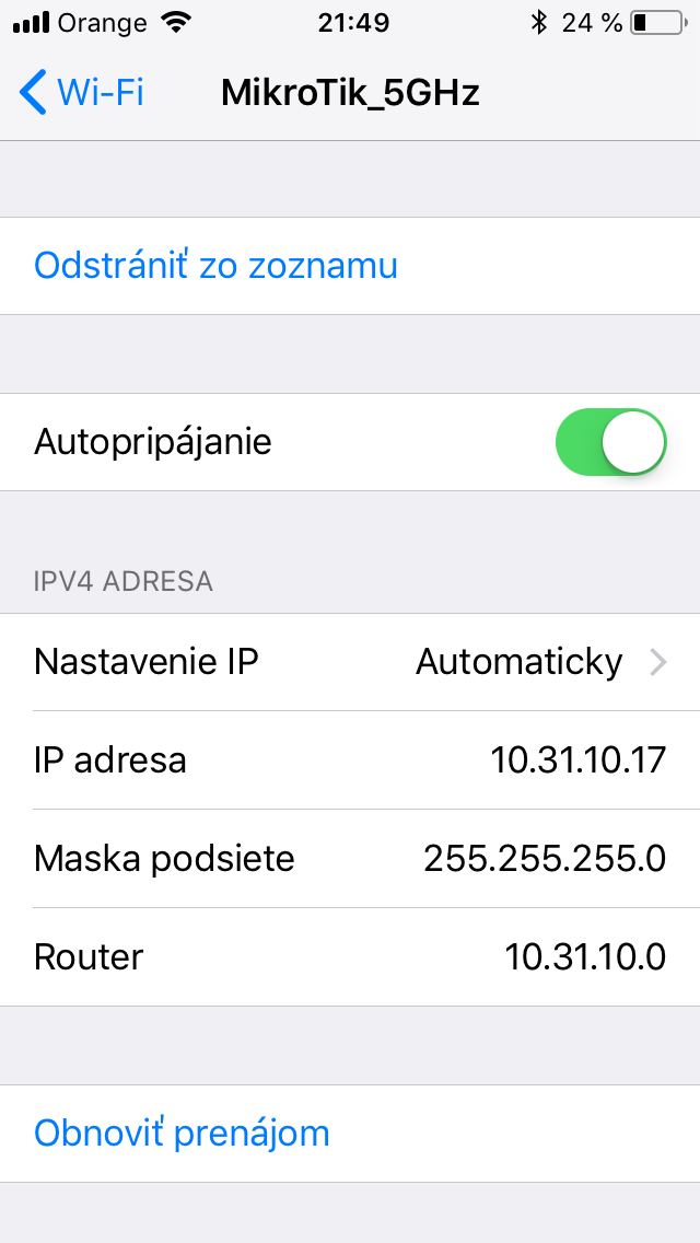

Wireless devices got:
IP address: 10.31.10.18
Mask: 255.255.255.0
Router (gateway): 10.31.10.0 (it’s gateway of RB962, maybe this must be 10.31.0.1?)
DNS are automatic but I see there correct DNS

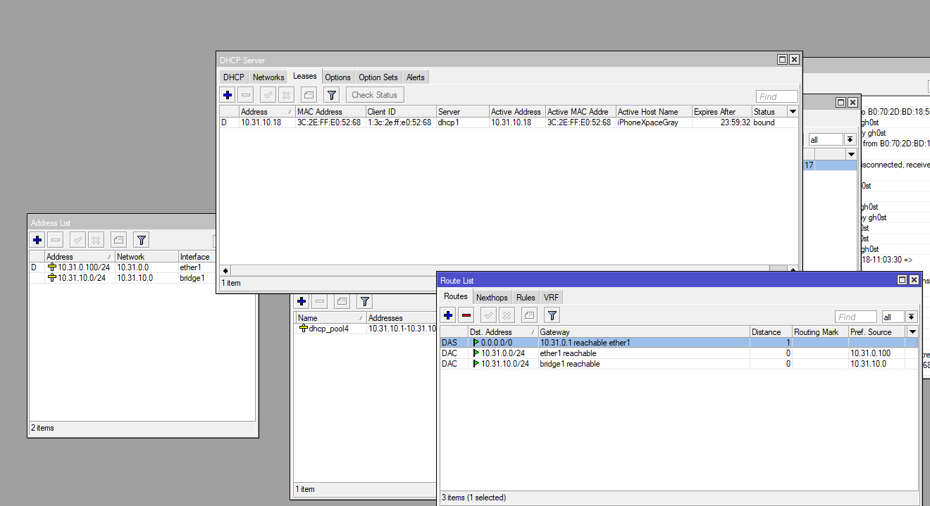

I found DHCP client in RB962 got correct gateway, only my wireless devices got 10.31.10.0 as gateway

Router 2
/Ip route 0.0.0.0/0
10.31.0.1 gateway = router1
Try above and see if that sorts it
I had it there
change the bridge address, it should be 10.31.10.1/24 not 10.31.10.0/24
