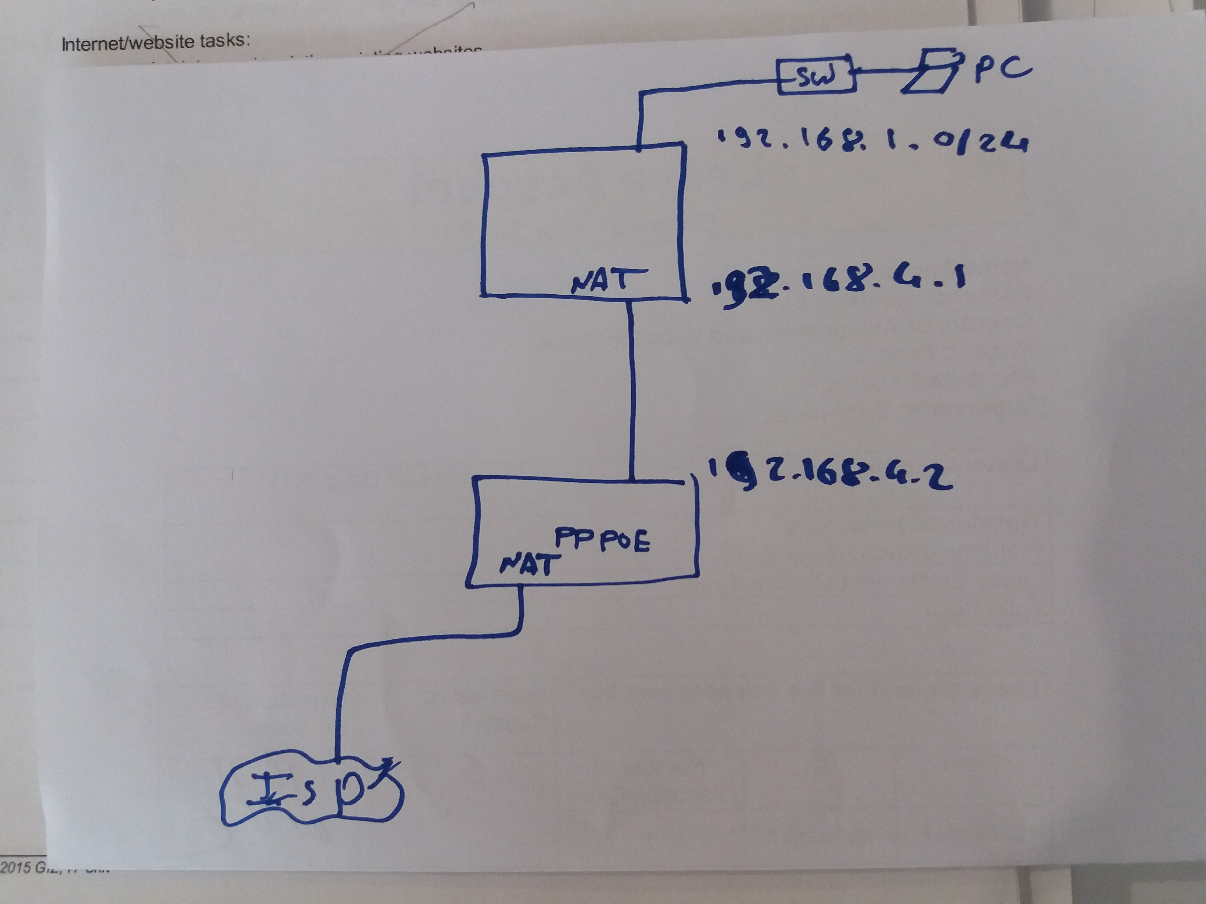

I have two mikrotik router end to end (NAT-NAT) and in between there is a DMZ. Actually, I don’t want NAT on the inner one. I want to use the gateway concept in routes so DMZ and the inner network can communicate without the need for port forwarding (dst-nat).
Please, advise how to configure the inner router.
thanks a lot in advance.
Diagram it. A photo of a handmade drawing made by mobile phone is sufficient.
Please, find attached the diagram. Please, let me know if you need any thing more.
Thanks a lot in advance.
If you want to keep everything unchanged and just get rid of the NAT on the Mikrotik with 192.168.4.1 on WAN, it is enough to add a route to the Mikrotik connected to the ISP:
add dst-address=192.168.1.0/24 gateway=192.168.4.1

I think sindy supposes that mikrotik is the gateway for 192.168.1.0/24 network. So traffic from 192.168.1.0/24 to 192.168.4.0/24 would flow through gateway.
For 192.168.4.0/24, I think gateway is internet. So you need route specify by sindy.
Devices in 192.168.1.0/24 must have a gateway from 192.168.1.0, which is the upper 'Tik, represented by its address from that range. But the upper 'Tik is in both networks simultaneously, so its own gateway to the world is the lower 'Tik.
Lower 'Tik’s gateway to the world is the ISP via the PPPoE interface, so you need an exception from that for 192.168.1.0/24, which is the route I gave, otherwise you would have to keep the NAT on upper 'Tik in place.
If you prefer something else (e.g. the devices behind the upper 'Tik to be in 192.168.4.0/24 because the connection between the two 'Tiks is a wireless one), you have to say that.

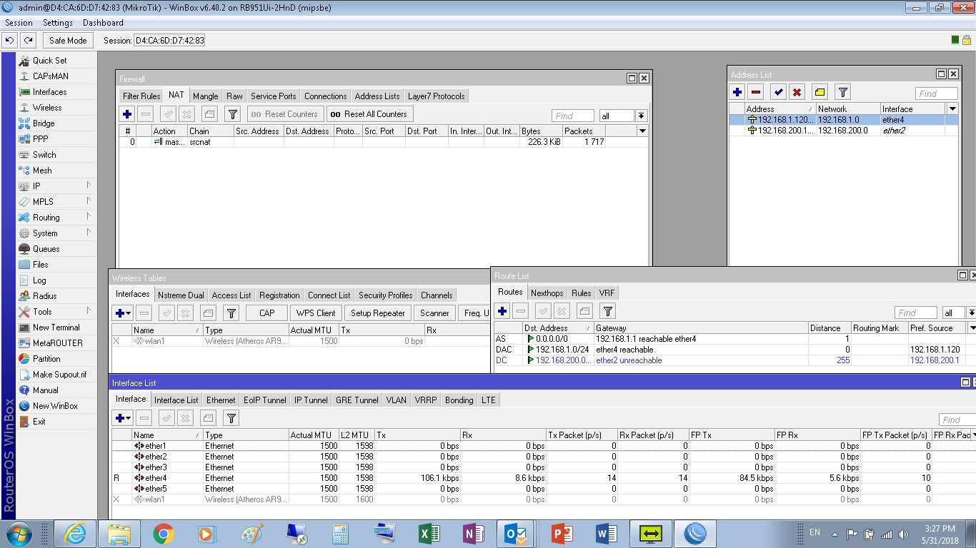

Actually, what you are proposing is something I have tried a lot but never succeeded. I guess there is something which I don’t understand in your scenario. For this, and in order not to intrupt the service here, I have created a similar scenario but with one mikrotik and an internet modem. Consider the internet modem is the internet edge nat. While the mikrotik is on the internal edge of the modem.
Internal IP of the modem: 192.168.1.1
External IP of the mikrotik: 192.168.1.120
Internal IP of the mikrotik: 192.168.200.1
The screen shot of the configuration of the mikrotik is attached. Please, let me know if you need something else.
I appreciate your advice.
Fawaz
With the modem in bridge mode and lower Mikrotik doing PPPoE and NAT to the IP provided by the ISP, it is actually simpler to configure than if the PPPoE and NAT is provided by the modem. The reason is that if you need the two LANs to reach each other without NAT between them, there is no other way than to use the exception route on the lower device (or you can use the upper device as a switch so that all local devices are in the LAN subnet of the lower device). And adding a route to the modem needs knowledge of the modem, and on many modems it is not possible at all.

  • Mikrotik
  • Internal
    I think mikrotik is the gateway. So, any machine in 192.168.200.0/24 network can reach 192.168.1.0/24 network
    The question is: does it exists a nat rule on outgoing traffic on 192.168.1.120 interface?
    If yes, machines in 192.168.1.0/24 network can answer traffic form 192.168.200.0/24 network
    If not, you need a route in modem that is 192.168.1.0/24 network gateway
    • 192.168.200.0/24 → 192.168.1.120
  • External
    If you want permit traffic from 192.168.1.0/24 to 192.168.200.0/24, you need previous route in modem
