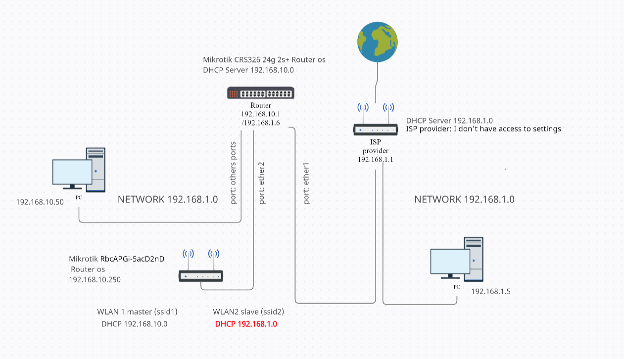

Hello, I want to apologize for the bad English.
please how do i get to the 192.168.1.0 network on WLAN 2?
I use masquerade on network 192.168.10.0
is this possible while maintaining the network structure?
To the ISP provider router I not acess
Thank you for the suggestions

Please post your config
It seems you want to have at least two subnets coming from the MT device as LAN subnets.
192.168.1.0/24 and 192.168.10.0.24
You have an access port going to the PC on vlan10
You have a trunk port going to the Access point carrying vlans 10 and lets say vlan 11 (for the 192.168.1.0/24 subnet).
You want the access point to have two WLANS
Does that describe your requirements???

If possible, I only want one network from MT.
I want the second network to go from the ISP router via crs326 to WLAN 2 .
On network 192.168.10.0/24 I only need internet access from ISP router.
Networks may not be visible to each other .
Yes I want to have access from Wlans to both networks.
This is my config on crs326 and Wireles AP

So the ISP device has several ports on it all giving out DHCP on 192.168.1.0/24 network.
You want the Wireless device to have WLAN1 on the subnet of the MT router and you want WAN2 to come directly from the ISP. but via the MT router connection.
You do realize that the WLAN2 and PC connected directly to the ISP device are not going through your routers firewall protections !!
WHY…

yes.
it doesn’t matter that wan 2 doesn’t go through the firewall
I can’t run everything via mt router because it’s far apart and I need mt router as a switch for other devices
If the configuration as I write is not possible.
the wan2 network can also be a ew subnet e.g. 192.168.2.0/24 which will pass through the MT router.
Wan2 subnet 192.168.2.0/24 will be visible on the 192.168.1.0/24 network
