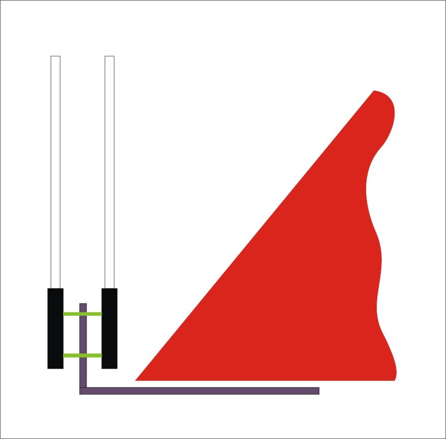

Can I connect two omni antennas to R52nH card as one for TX and other for RX at my AP (802.11g) like the image?
Will be it some improvement then one TX/RX antenna?
Thanks a lot

I wouldn’t.
I did and it didn’t work well.
Two vertical antennas, one above and one below works pretty well. Two beside each other don’t work well at all.
Above and below typically shows over 100% CCQ, beside each other shows around 50% ccq even when connected at 54 or 65mb moving tons of data, all single stream, dual chain config.
its better that you use a dual-pol omniantenna.
for ex. rfelements stationbox whit ubiquiti omniantenna works great.
