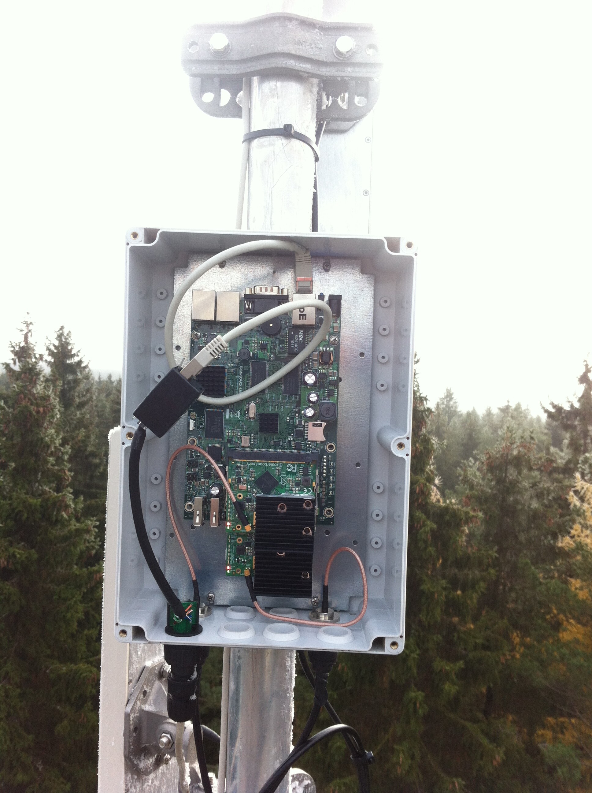

no, or you must modify the Heatsinks.
Very interesting, really should be necessary to cut only a part of the heatsink interface in socket 3, but we do not know what will happen next summer in Sardinia where we have very high temperatures the modified heatsink will succeed in its work
cetalfio
Two cards with unmodified Heatsink is only possible with RB435G or RB800.
The Card is specified up to +65C, it is far not so hot in East-Germany. Also i power the card with 26db and not with 29db.
Ultimately, the Heat of the modified Card must to be measured.
