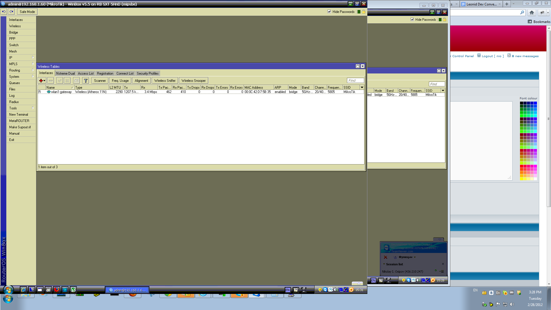

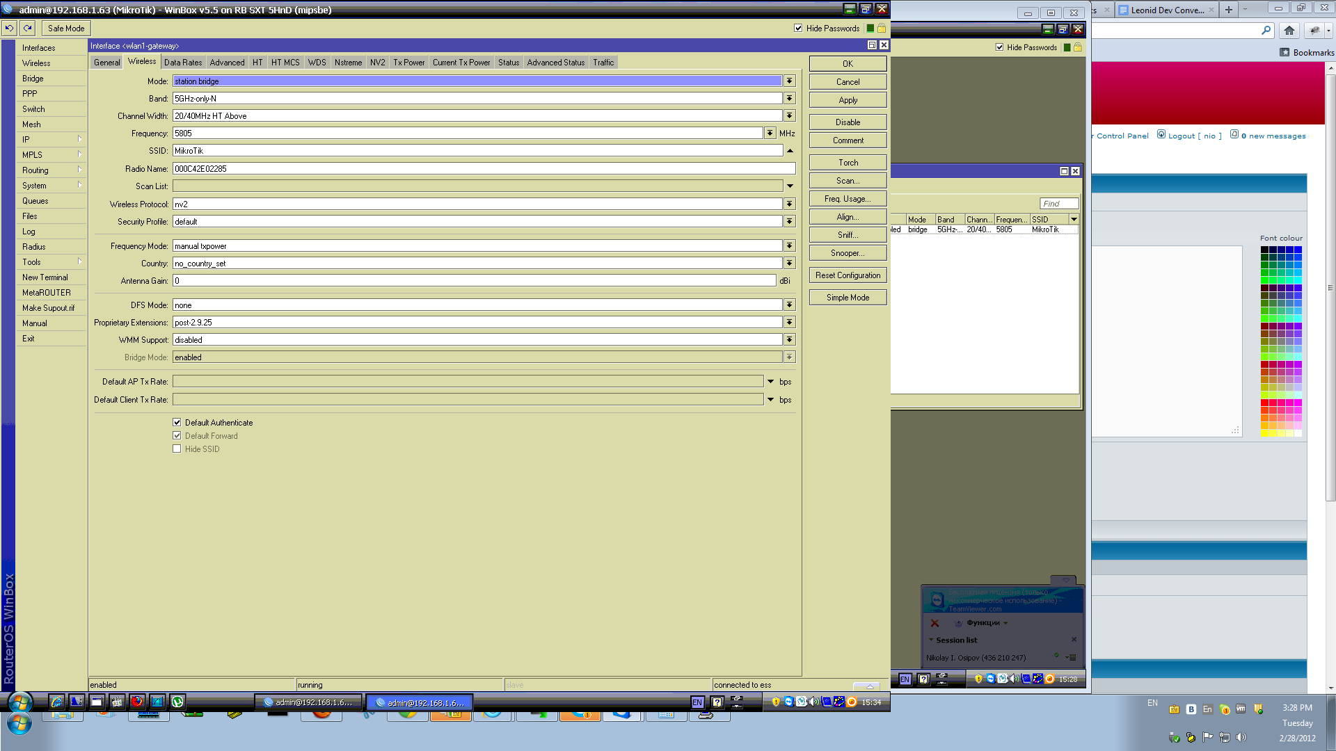

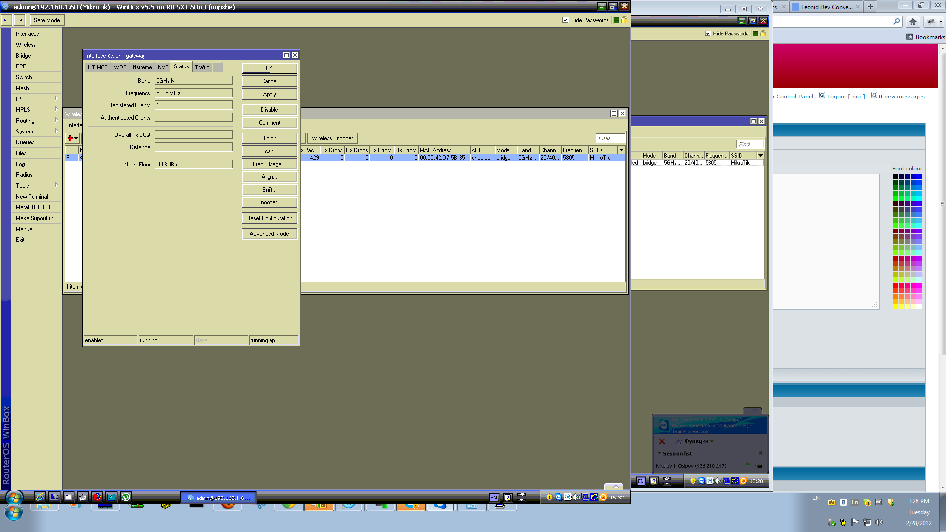

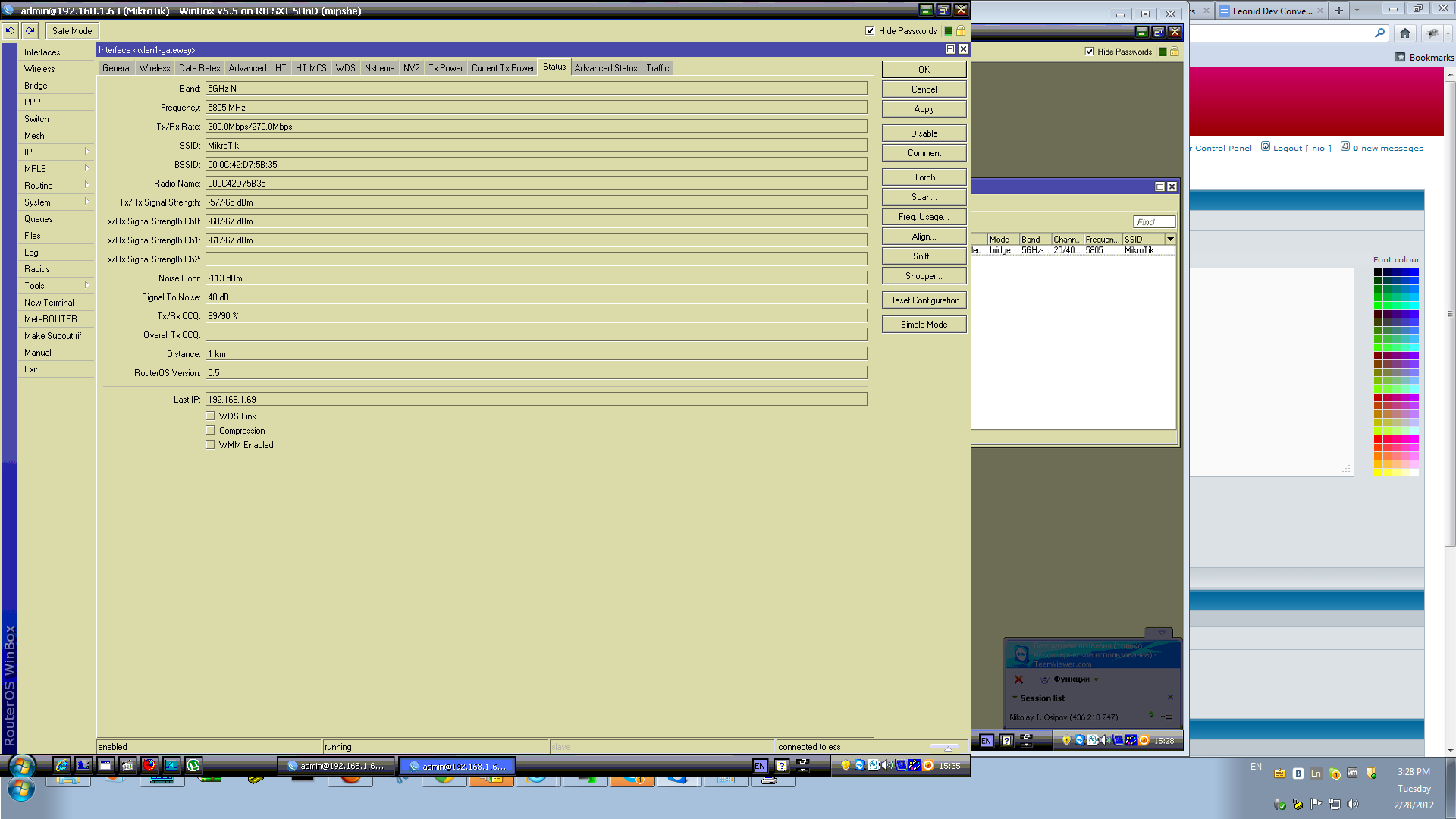

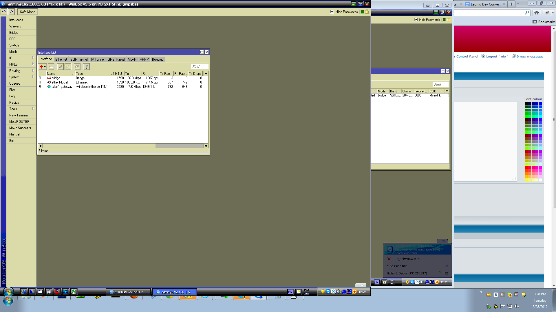

Please see screenshots w/ my config.
Client bridge below.
Station bridge in next post.

Screenshots for second station bridge sxt.

there sure is alignment issue with NIO cause those singals at client site in the screenshot r far too high for 50 mtrs. or may be NLOS
I get such signals at 4 km clear LOS. check for alignment.
