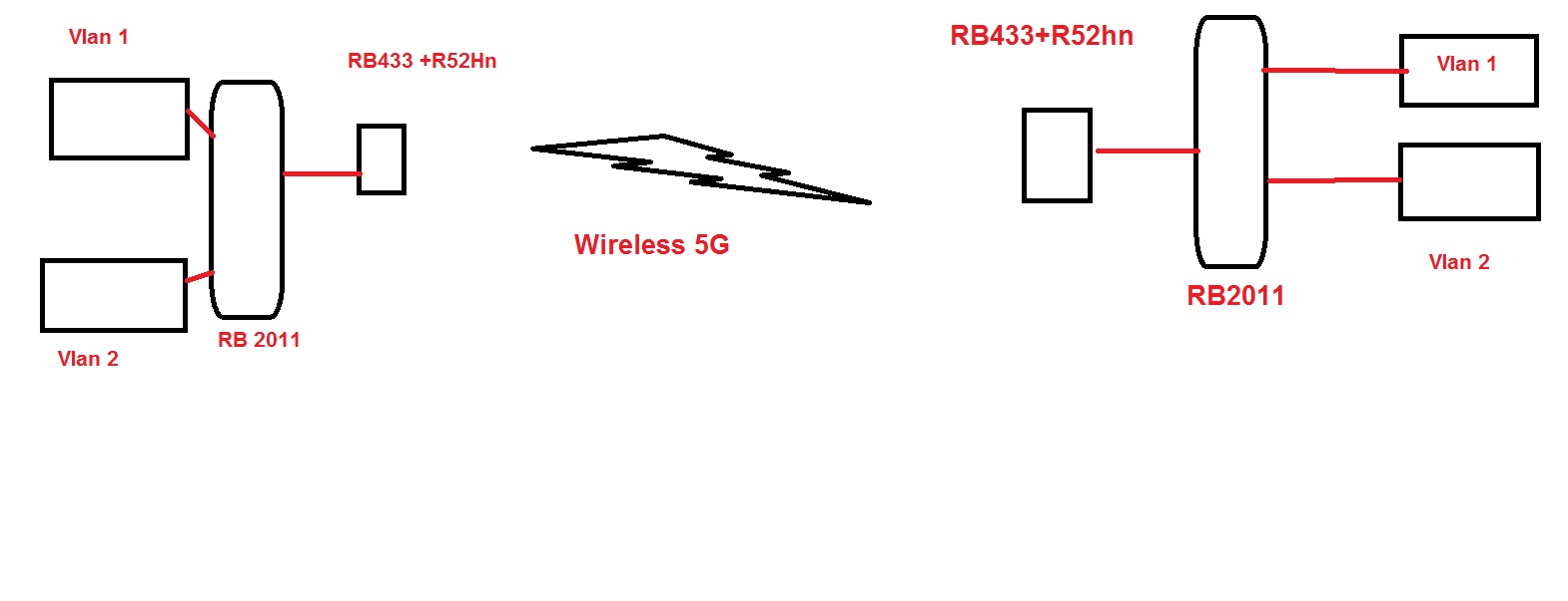

I have Rb 2011 RM for both side and RB433+R52hnd in each side and 2 vlan
how can i use 2vlan on wireless link
Can you give a little more info on your infrastructure, how is everything connected?
Maybe it can be done with two virtual access points on ther RB433’s
Plz check
Do the following on the RB2011’s
  • Create two VLAN’s on the interface connected to the RB433
  • Create two bridges
  • Add one VLAN interface to each bridge and add the corresponding interface for that VLAN into the same bridge.
If nothing else will be connected to the RB433’s do the following
  • Create a bridge
  • Add both the interface connected to the RB2011 and the wireless interface to the bridge
