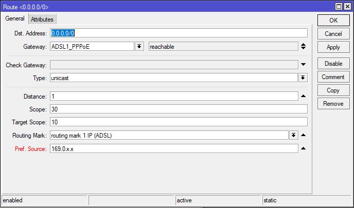

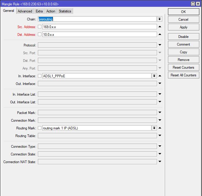

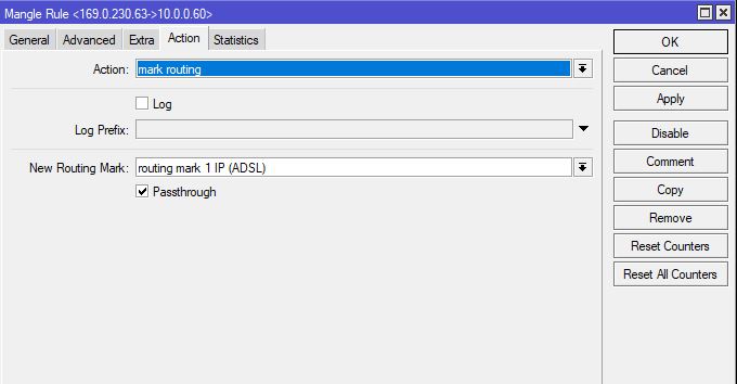

Because I cannot export the configuration I made screenshots of how I did the configuration. For the life of me I do not know what I am doing wrong

I think you’re looking for this:
add dst-address=0.0.0.0/0 gateway=ADSL1_PPPoE routing-mark="routing mark 1 IP (ADSL)"
/ip firewall mangle
add chain=prerouting src-address=10.0.x.x action=mark-routing new-routing-mark="routing mark 1 IP (ADSL)"
