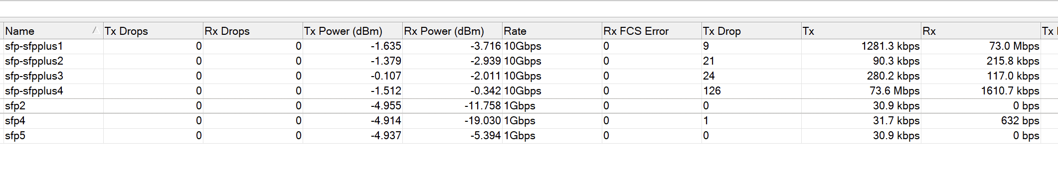

I am working an event and I wanted to link all my switches with 10gig off of my RB5009.. so I have 1 gig internet and im using the 10 gig SFP+ to connect to a CRS310 to connect to other switches.
Now im using all the ports on the LAN side.. so all 4 SFP+ ports (@ 10gig) and all 5 1gig ports (@1gig).. But im noticing these “tx-drop” counters going up but NOT “tx-drops” dont know if that means anything but still im concerned.. right now the event is not using much traffic but we will get close to that 1 gig im certain of it. im also seeing no FCS errors at all.. so I dont know.. I was hoping I could get some insight ..
Oh and the one with the highest drops is the one connected to the RB5009.. for the LAN networks trunked
would tx or rx flow control help ?
