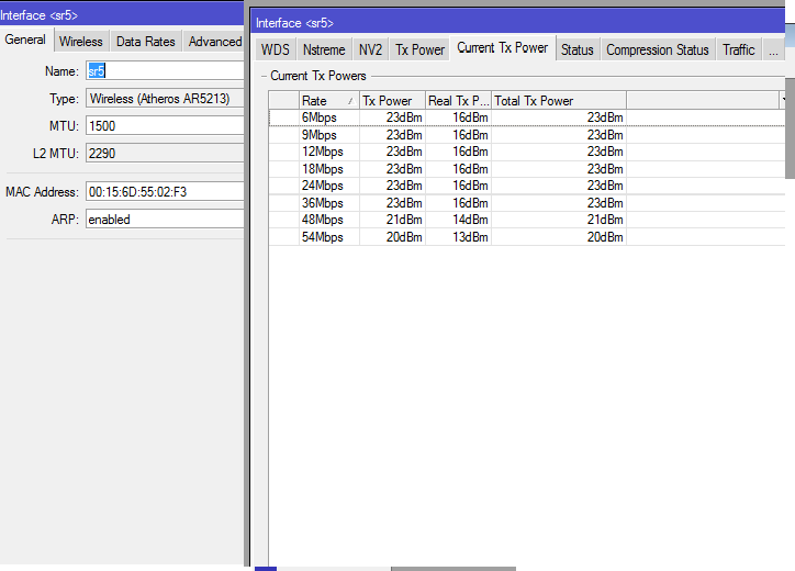

Im having issue with the TX power for almost all XR/SR cards (SR2/XR2 and SR5/XR5) always the real TX power is lower than the max card power i use a 24V power adapter and same issue
can any one help

Power Offset see
http://www.ubnt.com/downloads/SRXR_power_offset.pdf
