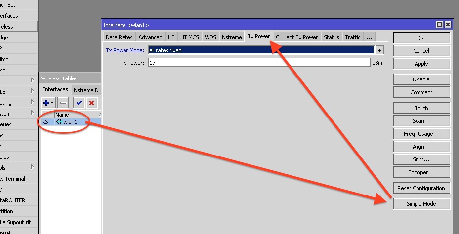

Is there any way to change the TX power of SXT G-2HnD. I am using as AP with ROS 5.25
Yes, you can decrease it. Use the “all-rates-fixed” setting in Wireless.
Enable “Advanced Mode” first.
Why use ‘all rates fixed’ rather than ‘card rates’?
According to this link, it says you should avoid using ‘all rates fixed’: http://wiki.mikrotik.com/wiki/Manual:Wireless_FAQ#What_TX-power-mode_is_the_best.3F
