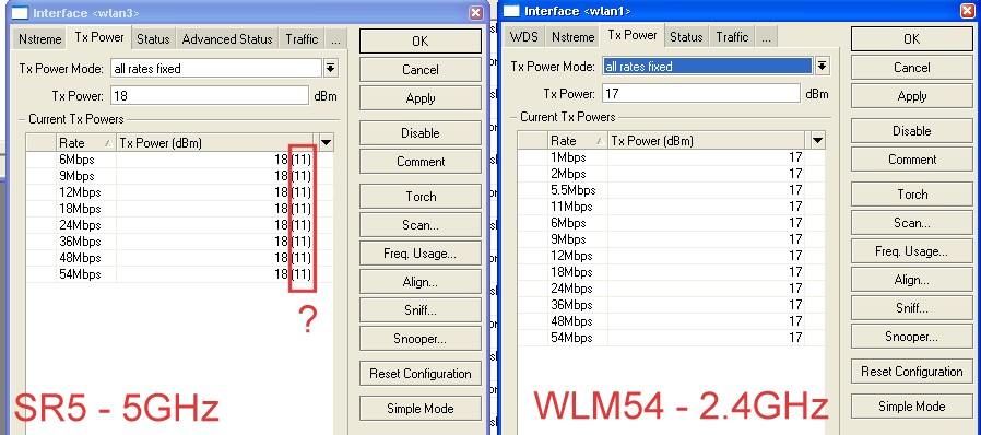

I not undestand a tx-power values in SR-5 miniPCI card…
What is the real tx-power? 18 or 11 dBm?
See the image…
tnx
See the image…
tnx
ok, solved: http://forum.mikrotik.com/t/tx-power-rates-which-is-the-real-one/23153/1
omega-00
To sumarise what I gleaned from that, the Ubiquiti cards are set to give a higher output than what they say due to the madwifi driver not supporting the high power output (26dBm) so mikrotik has made corrections for these specific cards, meaning when I put in a value, like the case above of 20dBm, the mikrotik sends the command to the SR2/SR5/SR9 as “10dBm” and the card ACTUALLY outputs 20dBm as it is set to do.
