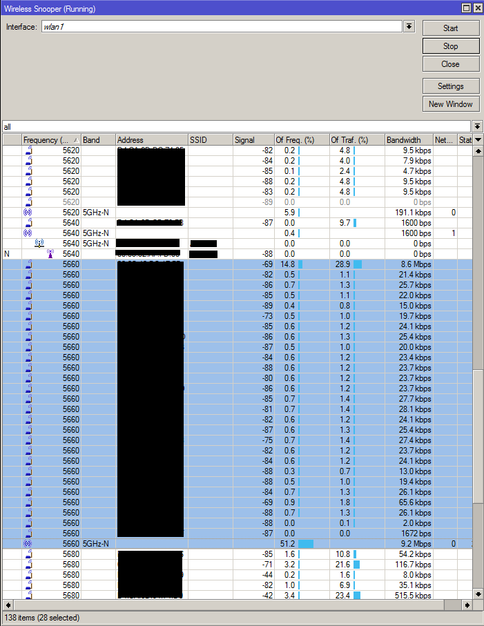

The “Freq. Usage” of AP frecuency, reported by a near SXT of AP, is very high, 50% -70% with 1Mb-5Mb Tx rates … and when I change the frequency, this consumption is transferred to the new frequency, so It is my AP consumption… But I do not know how to locate the problem.

Here is a Wireless Snooper capture. All 5660 frequency devices are my Omnitik + 27 SXT Clientes. The first device with the high consumption is the omnitik AP.
The screenshot was made by a SXT a little far, so the signal values ​​are high. But the values ​​are correct for the AP.
