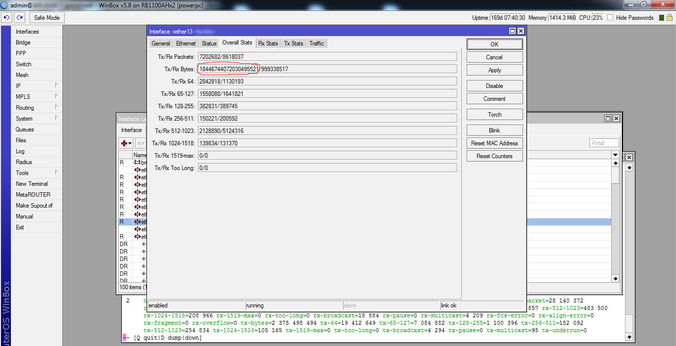

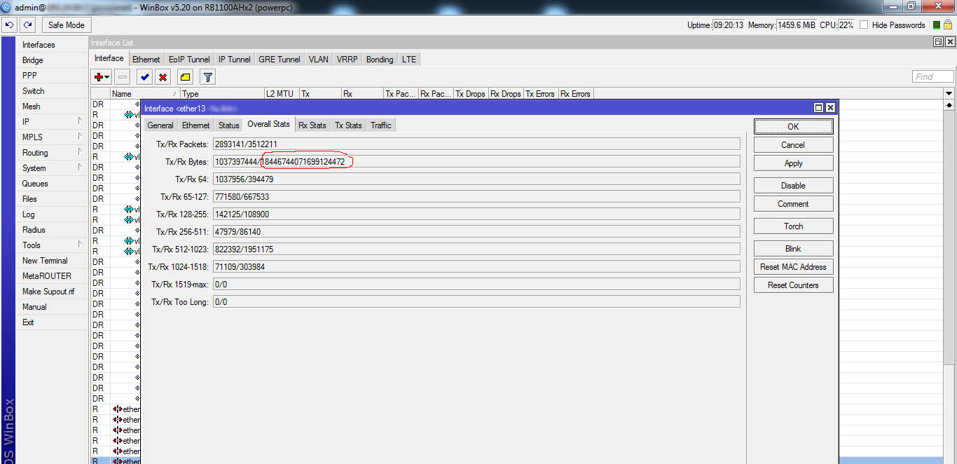

i have this problem that on an ethernet interface with a roughly 40-50mbps avg traffic the tx/rx counters go mad.
After i reset the counters it few minutes everithng looks fine then in a second one or both jump to huge numbers.
Here is the ss:
Is this happening to you too? How can i fix it?

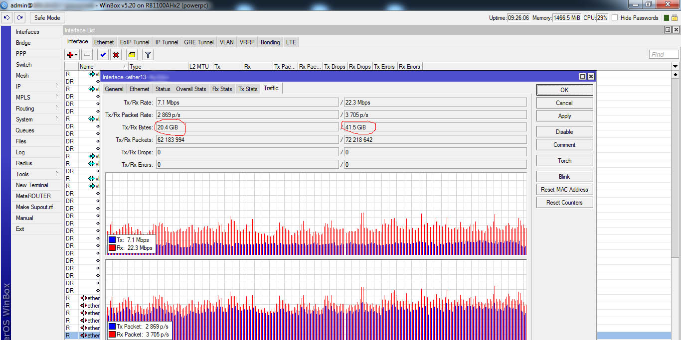

On the other hand, i would presume that these numbers are ok:
