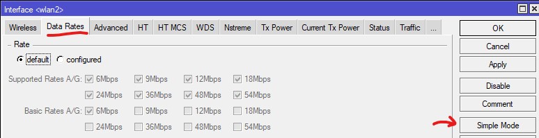

I didn't set those, I updated from 6.46.6 to 6.47 then noticed this issue.

This has been set (in “advanced mode”, tab “Data Rates”), maybe unknown when or how, different from the default, to very specific values
basic-rates-a/g=54Mbps
rate-set=configured
supported-rates-a/g=54Mbps
